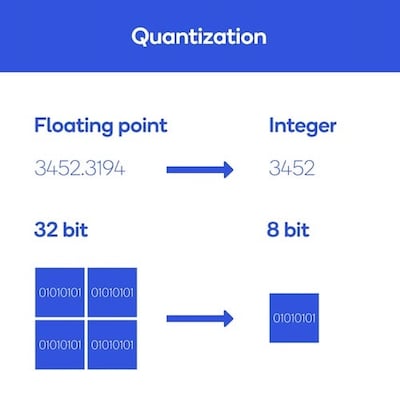

Quantization shrinks neural networks
Quantization shrinks neural networks by decreasing the precision of weights, biases, and activations. Image used courtesy of Qualcomm
The architecture also supports both vanilla and quantized LLM models and executes floating-point computations, including FP32, FP16, BF16, and FP8. Further, the NPU also supports four-bit and five-bit quantization (Q4_K, Q5_K) to reduce memory requirements by up to 75% and increase inference speed by 276%.

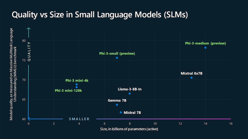

Comparing quality and size in LLMs
Comparing quality and size in LLMs. Image used courtesy of Microsoft
RaiderChip claims the GenAI v1 offloads more than 99.99% of inference computations to dedicated hardware, with only a lightweight software layer handling model support and updates. This software layer is under 200 KB and functions autonomously without external dependencies like PyTorch or Hugging Face Transformers. The architecture’s adaptability allows new models to be integrated with minimal effort, with support for fine-tuned versions of existing transformer-based LLMs requiring no additional modifications.
