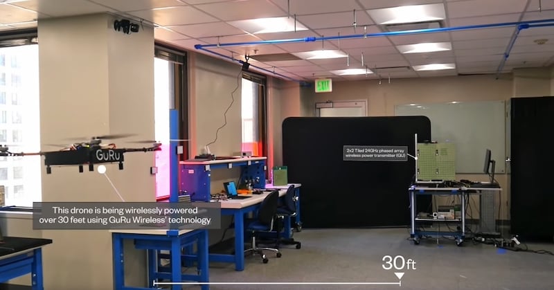

GuRu Wireless recently demonstrated its wireless power transfer system powering an untethered drone from 30 feet away. This demonstration highlighted the practicality of long-range energy transfer and how it integrates power delivery with communication. GuRu attached a recovery unit to the drone that worked with a transmitter to optimize power delivery dynamically, ensuring it received only the energy it needed. In the test, the drone operated for 96 hours without recharging—a game-changing improvement over the typical 30–45 minutes of drone operation time.
Guru wireless power transfer system
In GuRu lab, the team demonstrated its latest architecture with a transmitter configuration directly powering an untethered drone across 30 feet.

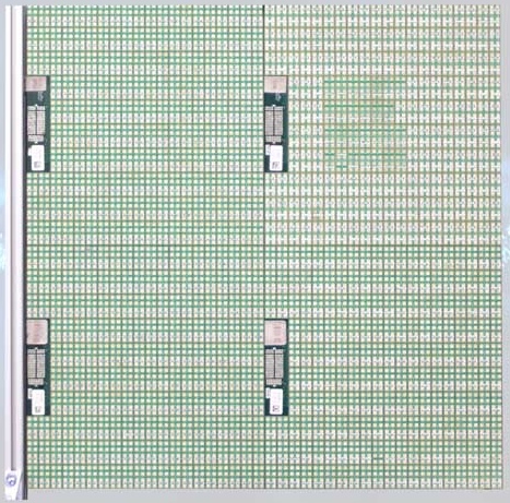

GuRu’s system uses high-frequency millimeter-wave radio signals instead of the usual inductive coupling in many wireless charging systems. Operating at 24 GHz, this approach can transfer energy over several kilometers. The system sends targeted beams of non-ionizing radio waves—similar to the frequencies used in 5G networks—to a receiving device.
GuRu’s modular wireless power transfer system
GuRu’s modular wireless power transfer system operates at 24 GHz.

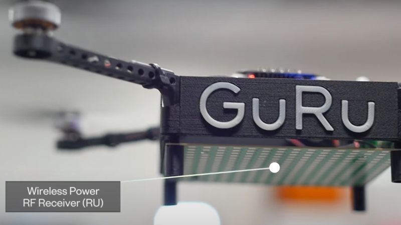

This targeted energy transfer requires precision. The transmitter is equipped with proprietary radio frequency integrated circuits (RFICs) that are the "smallest 24-GHz modules in the industry." These modules are assembled into tiles, creating a phased array architecture that efficiently directs energy. A recovery unit on the receiving device communicates its location and power needs, ensuring accurate power delivery.

This modularity translates to flexibility across different industries and applications. For large-scale applications, such as powering industrial IoT networks or automotive charging stations, the system can be expanded by adding more tiles. Alternately, the recovery unit offers a lightweight and compact solution for smaller, space-constrained devices.
A drone being wirelessly powered over 30 feet
A drone being wirelessly powered over 30 feet using GuRu's 24-GHz, phased-array wireless power transmitter.
