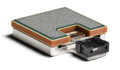

IBM’s prototype
IBM’s prototype polymer optical waveguide solution. Image used courtesy of IBM

IBM designed its new co-packaged optics technology to improve data center energy efficiency and bandwidth, particularly for generative AI computing.
To do this, the research team integrated optical link connections directly onto circuit boards and chips utilizing polymer optical waveguides to achieve high beachfront density. The polymer waveguides support a 50-micron pitch for optical channels—an 80% reduction compared to traditional 250-micron pitch designs. As a result, the systems achieved a 1,000% to 1,200% increase in bandwidth capacity. Importantly, the optical fibers, measuring 250 microns in diameter, maintained alignment tolerances of under half a micron to guarantee high-fidelity connections.
The prototype co-packaged optics module
The prototype co-packaged optics module. Image used courtesy of IBM
IBM also claims that the technology delivers significant energy efficiency improvements, reducing energy consumption by 80% from five picojoules per bit to under one picojoule per bit. Meanwhile, the photonic integrated circuit (PIC) connections achieved insertion losses below 1.2 dB per channel, outperforming the standard 1.5-2-dB range, while cross-talk remained under 30 dB. The waveguides also support multi-wavelength data transmission, potentially increasing bandwidth by up to 8,000%.
