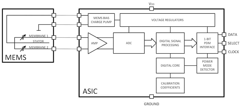

The new Xensiv microphones are equipped to handle environmental stress without sacrificing performance. The IM72D128V features a high signal-to-noise ratio (SNR) of 71.5 dB(A) and ultra-low current consumption of 430 µA in high-performance mode and just 160 µA in low-power mode.
Block diagram of the IM72D128VV01
Block diagram of the IM72D128VV01.
Its sealed MEMS design prevents water and dust ingress at the membrane level, eliminating common failure modes such as electric leakage or mechanical blockage. These specs make it well-suited for far-field pick-up in ANC headphones, smart speakers, or rugged monitoring systems.

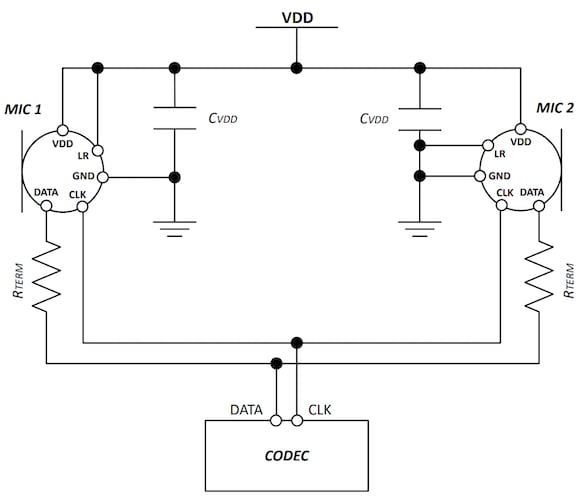

While Infineon’s proprietary SDM technology is key to the microphones’ environmental robustness, their ability to operate with minimal power draw is equally important. Both microphones allow dynamic switching between performance profiles without introducing audio artifacts, a significant feature for battery-operated devices that must balance standby power and active audio performance.
Typical stereo mode configuration of the IM69D129FV01
Typical stereo mode configuration of the IM69D129FV01.
Each unit is factory-calibrated to within ±1 dB of sensitivity, which simplifies the use of multiple microphones in array configurations while maintaining phase and amplitude consistency. Additional specifications, such as a low total harmonic distortion (THD) of 0.1% at 94 dB SPL and a 128-dB SPL acoustic overload point, enable these MEMS microphones to handle both quiet and loud sound environments without clipping or distortion.
