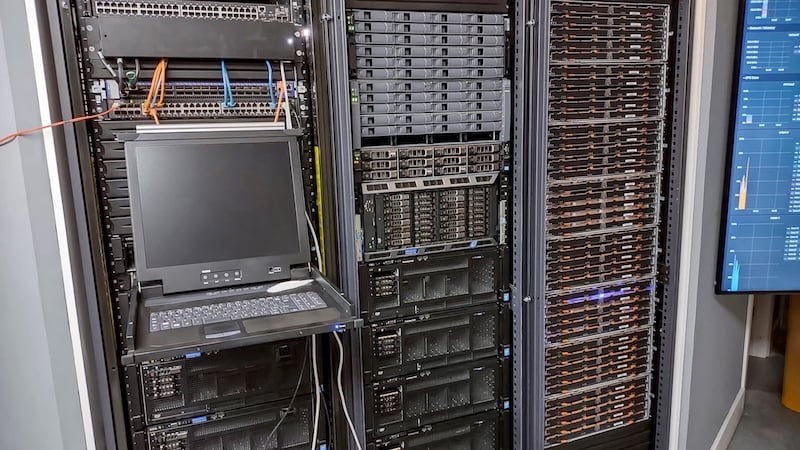

With GPU clusters continuing to scale upwards, copper interconnects are struggling to keep pace.
With GPU clusters continuing to scale upwards, copper interconnects are struggling to keep pace. Image used courtesy of Adobe Stock (licensed).
As GPU clusters expand from dozens to hundreds to thousands of accelerators spread across multiple racks, copper simply cannot bridge the gap. The AI scale-up networks of tomorrow—the dense, high-bandwidth fabrics that allow thousands of GPUs to coordinate as a single computational entity—require something fundamentally different.

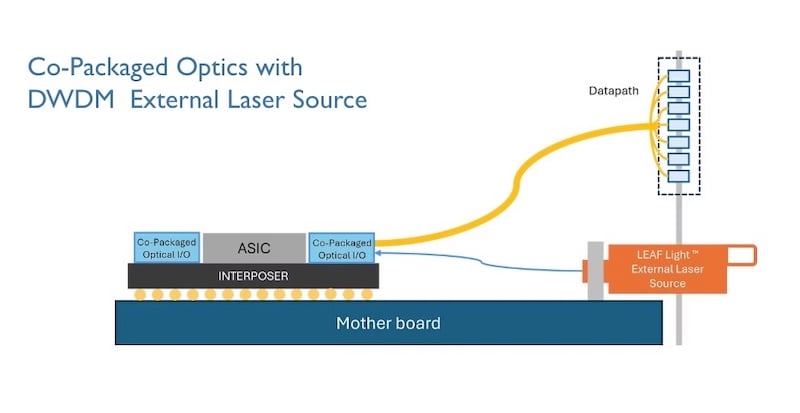

The emerging solution is co-packaged optics (CPO)—integrating the optical engine directly alongside the compute ASIC or GPU on the same substrate, eliminating the long electrical trace between processor and transceiver. But not all CPO architectures are equal. The mainstream approach uses CWDM (Coarse Wavelength Division Multiplexing), which packs four optical channels onto a fiber at up to 200 Gbps per channel. It improves on pluggables, but it's a half-measure.
The more promising architecture—and the one that Scintil Photonics is betting the company on—is DWDM CPO: Dense Wavelength Division Multiplexing combined with co-packaged integration. The performance gap between the two is stark. Where CWDM CPO delivers latency of 50 to 100 nanoseconds and energy efficiency around 7 picojoules per bit, DWDM CPO achieves latency below 5 nanoseconds and energy efficiency under 3.5 picojoules per bit.
Scintil’s approach is to combine DWDense Wavelength Division Multiplexing (DWPM) with co-packaged integration.
Bandwidth density scales to more than 8 terabits per second per millimeter—roughly eight times that of CWDM CPO—and a single fiber can carry up to 1,600 Gbps. When measured against legacy pluggables, DWDM CPO delivers a 6x reduction in power consumption.

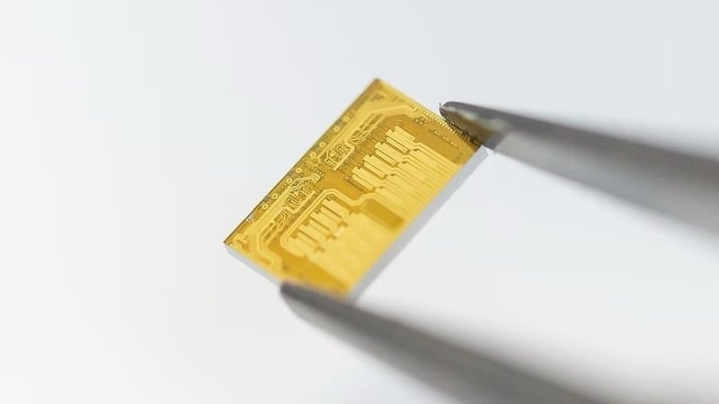

Scintil’s LEAF Light
Scintil's first commercial product, the LEAF Light, is the world's first single-chip DWDM laser source designed for AI-scale co-packaged optics. It supports configurations of 8 or 16 wavelengths on a single chip, with frequency spacing precision of ±10 GHz—the tightest in the industry. Each wavelength carrier delivers up to 20 milliwatts of optical power, with wall-plug efficiency of approximately 20% at operating temperature.
LEAF Light is a single-chip DWDM laser source designed for AI-scale co-packaged optics.
Critically for data center operators, LEAF Light eliminates the failure modes most commonly associated with high-speed lasers. By removing the need for anti-reflection coatings and avoiding current flow through the grating structure, the architecture achieves stable, mode-hop-free operation. This reliability characteristic matters enormously at the scale of modern AI infrastructure, where a single failed optical component can degrade the performance of an entire GPU cluster.
