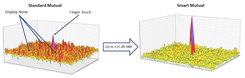

The core of the ATMXT3072M1-HC and ATMXT288M1 is Microchip’s proprietary charge-transfer acquisition engine and Smart Mutual capacitive sensing technology. Microchip’s platform augments mutual capacitance measurements with advanced signal processing to improve touch signal-to-noise ratio (SNR) by up to 15 dB compared with previous maXTouch generations. With higher SNR, the controllers can support more reliable touch detection on displays with high capacitive loads and strong noise coupling, such as on-cell OLED panels.

Microchip’s proprietary Smart Mutual acquisition technology enhances touch SNR by +15 dB without increasing the Tx drive voltage.
Microchip’s proprietary Smart Mutual acquisition technology enhances touch SNR by +15 dB without increasing the Tx drive voltage. Image used courtesy of Microchip.

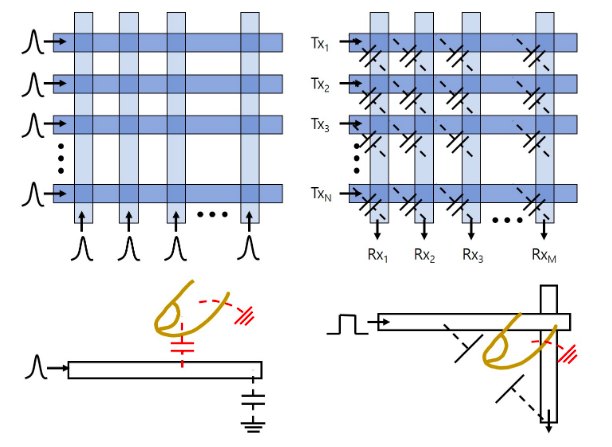

Diagram showing self-capacitance (left) and mutual capacitance (right) touchscreen methods.
Diagram showing self-capacitance (left) and mutual capacitance (right) touchscreen methods. Image used courtesy of Nam and co-authors.
To respond to these changes, modern automotive touch controllers rely on adaptive sensing techniques. The two basic capacitive touchscreen methods are mutual capacitance and self-capacitance. Mutual capacitance measurements detect changes between intersecting electrodes, while self-capacitance measurements reference electrodes to ground to identify absolute capacitance changes.
By combining the two methods, controllers can distinguish valid touch events from noise sources such as conducted interference or moisture.
