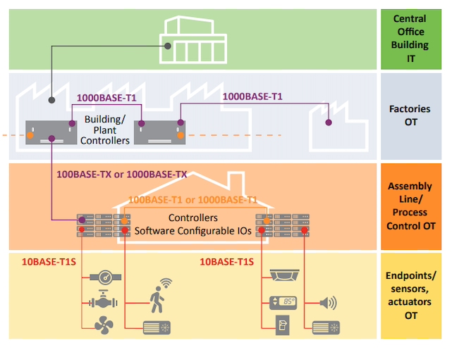

Single-pair Ethernet implementations
Single-pair Ethernet implementations.

10BASE-T1S is particularly well-suited for RCP due to its multidrop topology and low signaling complexity. While 100BASE-T1 or higher-speed variants typically require point-to-point links and PHY negotiation, 10BASE-T1S allows multiple devices to connect over a single pair of wires. The IEEE 802.3cg standard specifies operation at 10 Mbps with deterministic, full-duplex communication and minimal latency. Such features make the standard appropriate for control and sensor networks in zonal architectures.
