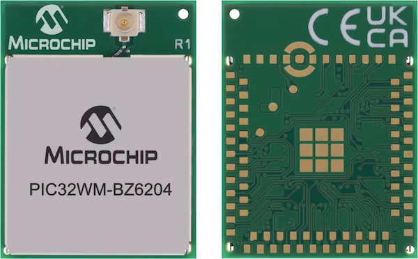

The PIC32WM-BZ6204UE module comes on an 83-pin chip carrier PCB, including a center thermal pad and support components. The 10 mm x 10 mm SoC is situated under a metal shield and adds a micro-FL connector. The key ingredient is the RF certification that comes with the module.
PIC32WM-BZ6 wireless module, front and back
PIC32WM-BZ6 wireless module, front and back.
This enables the development and production of larger devices without the need for an independent RF certification process. It includes certifications under FCC, CE, UKCA, and ISED.

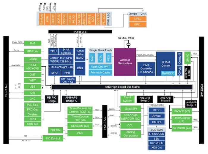

Human interface comes with up to 18 channels of capacitive voltage divider (CVD) touch-screen capability. Output can use the low-cost controllerless (LCC) graphics to directly drive 8-bit color on a 480 x 272 TFT display.
PIC32CX-BZ6 block diagram
PIC32CX-BZ6 block diagram. (Page 22 of the datasheet)
The SoC comes with a generous set of motor control support functionality. It has multiple hardware PWM interfaces (up to 32), 12-bit ADCs, 7-bit DACs, analog comparators, and quadrature encoders.
