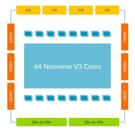

Per-die specifications of a Neoverse CSS V3 subsystem
Per-die specifications of a Neoverse CSS V3 subsystem. Image used courtesy of Arm
Arm built CSS V3 to be modular, so that hyperscale cloud providers and silicon partners can focus on workload-specific optimizations without modifying the core design. To do this, Arm provides a verified subsystem with integrated fabric, cache coherence, and power management, reducing design complexity and time to silicon. CSS V3's approach also lets designers tune power and performance more granularly.
Moreover, CSS V3 includes built-in hooks for custom silicon extensions. It was this extensibility that allowed Microsoft to integrate unique features such as per-core DVFS and on-die accelerators without altering the core CPU logic.
