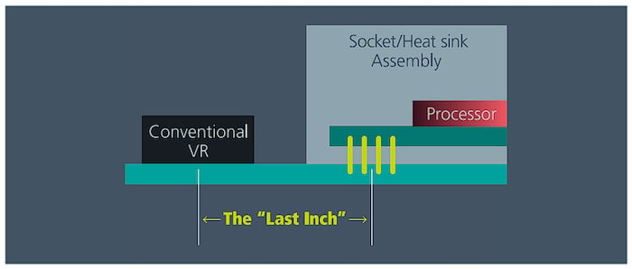

Last inch
With traditional PDN systems, it is difficult or impossible to analyze the PDN’s performance in the “last inch,” where power is routed to an assembly or individual transistors on-chip. Image used courtesy of Vicor
On-chip, however, is another story. In the case of fabricated silicon, it is not always possible to directly probe the transistor-level voltages that can drastically impact circuit performance. In the case of SoCs or high-power processors, the transistor-level voltages can have a major impact on the efficiency and performance of the resulting chip. Currently, it is possible to model these dynamics, but intra- and inter-wafer process variations can still not be easily accounted for. As a result, a robust and efficient on-chip power analysis solution could be a useful tool for designers.

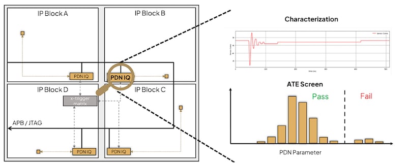

Movellus is taking a process-agnostic approach with its PDN IQ, which can be integrated into several different processes for maximum flexibility. Each PDN IQ can provide up to nanosecond resolution, making even the fastest transients on GHz-clock chips readily accessible.
PDN IQ system

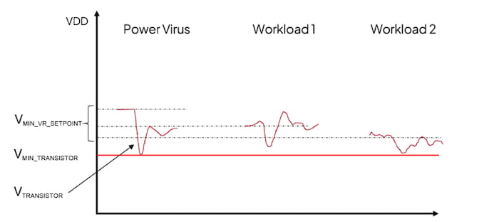

Using the Movellus PDN IQ system, designers can determine the effects of various workloads or nonidealities, such as those shown above, on individual transistor voltages to boost overall performance.
This bit of Movellus IP provides considerable new insights into the dynamic operation of SoCs, and allows designers to make more informed decisions at every step in the fabrication process. In characterization, the PDN IQ optimizes the chips’ performance levels while simultaneously providing a new route to evaluating performance during testing or heterogeneous integration. Finally, in the field, designers can use the PDN IQ to analyze each unique workload and determine the best voltage level for maximum performance.
