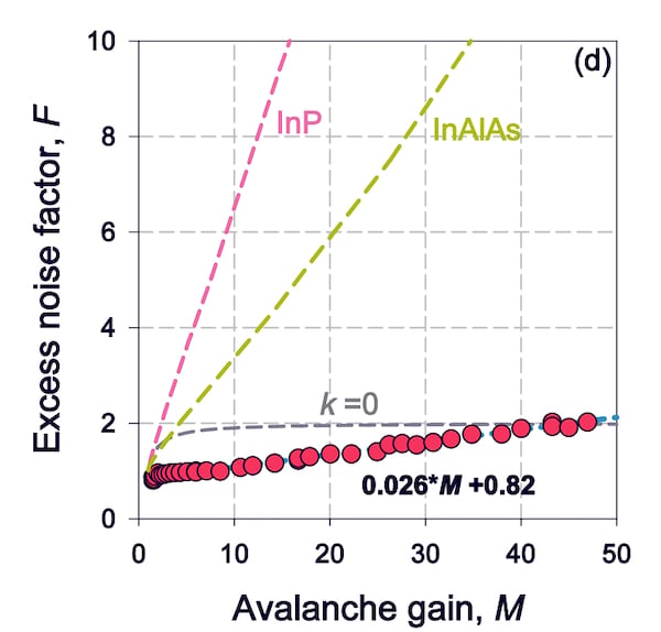

The Noiseless InGaAs series of APDs features low-noise factors, with values of 1.08 and 1.86 at avalanche gains of 10 and 40, respectively. This translates to a noise equivalent power of 5.2–5.6 fW/Hz, enabling small amounts of incident light to be detected. The noise performance is highly dependent on the configured avalanche gain, with very low noise at low gain and a greater noise factor at higher gain levels.
As avalanche gain increases, the noise performance can degrade
As avalanche gain increases, the noise performance can degrade. Compared to other technologies, however, the new APD shows improved noise performance even at high gains.
