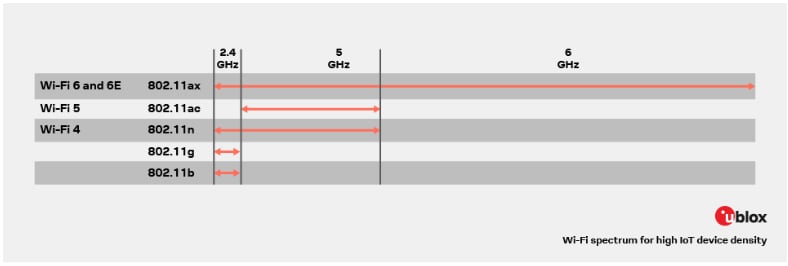

The Jody-W6 supports the 6 GHz band, along with 2.4 GHz and 5 GHz, giving it access to additional spectrum compared to earlier Wi-Fi designs. It supports Wi-Fi 6E with 2x2 MIMO and concurrent operation, with data rates up to about 1.2 Gbit/s in the 5-GHz and 6-GHz bands.
Wi-Fi 6E adds access to the 6-GHz band
Wi-Fi 6E adds access to the 6-GHz band alongside traditional 2.4-GHz and 5-GHz operation.
The Jody-W6 will also use features like OFDMA and higher spectral efficiency to handle multiple devices simultaneously with lower latency, making it better suited for dense deployments where consistent throughput and reliable connections matter.

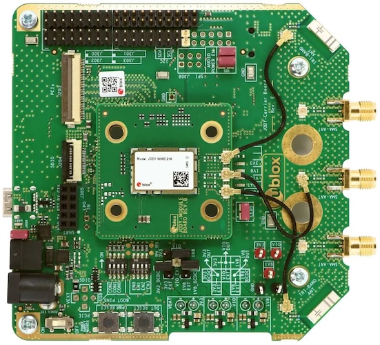

The EVK-JODY-W6 evaluation kit.
Depending on the model, it can operate from -40°C to +85°C, with some versions extending to +105°C for harsher environments. U-blox is also supporting the module with evaluation kits and an M.2 option, which should make development and integration a bit easier for teams moving into Wi-Fi 6E designs.
