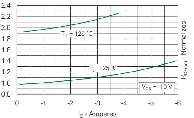

RDS(on) vs. drain current for the IXTY2P50PA. Image used courtesy of Littelfuse
Littelfuse says this AEC-Q101-qualified transistor is its first automotive-grade PolarP P-Channel Power MOSFET. One of the standout features of this MOSFET is its low conduction loss, characterized by a maximum on-state resistance of 4.2 Ω. Additionally, the MOSFET offers excellent switching performance due to its low gate charge of 11.9 nC, enabling fast and efficient operation. With an avalanche energy of 150 mJ and a dynamic dv/dt rating of 10 V/ns, this FET aims to serve automotive applications requiring durability and reliability.
