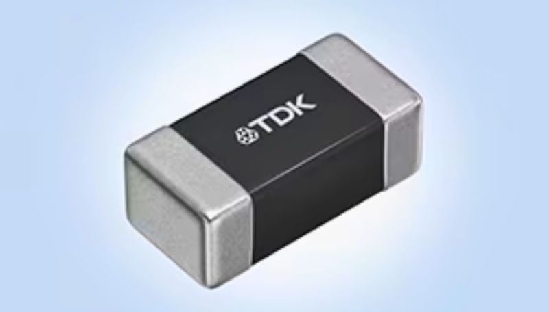

TDK’s Multilayer Chip Beads
TDK introduced its MPZ1608-PH series, which expands the performance ceiling of its multilayer chip beads by offering an 8 A rated current in a 1608-size footprint. According to TDK, this current handling marks the highest in the industry for power line noise suppression components of this form factor. The design refines both the internal material composition and the bead’s geometric structure.
TDK’s MPZ1608-PH series
TDK’s MPZ1608-PH series. Image used courtesy of TDK
The major benefit is reduced component count. Most circuits exceeding 8 A typically require two beads in parallel, which introduces current imbalance and design complexity. By supporting 8 A through a single component, the MPZ1608-PH series reduces the number of components and halves the PCB footprint relative to conventional parallel configurations. And, with a low maximum DC resistance of 4 mΩ and a nominal impedance of 22 Ω at 100 MHz, the beads maintain effective noise suppression without introducing substantial loss. The rated current remains valid up to 85°C and derates to 5 A at 125°C.
