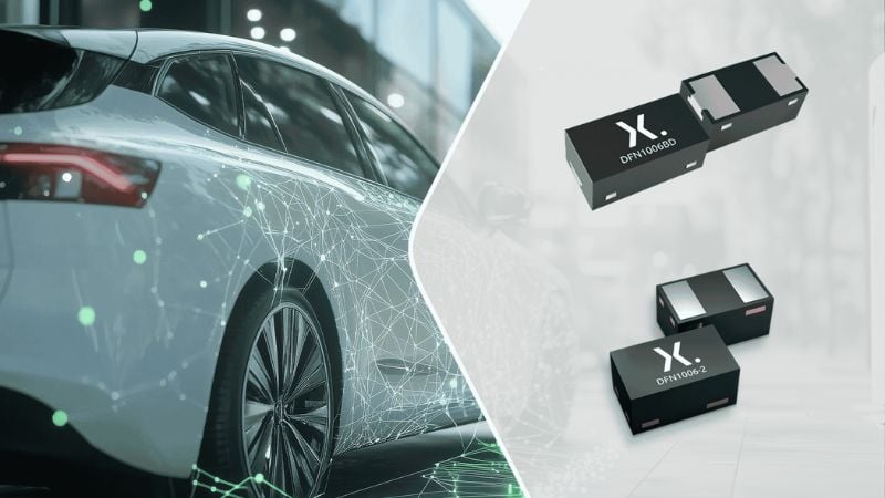

Nexperia has released the PESD1ETH10L-Q and the PESD1ETH10LS-Q
Nexperia has released the PESD1ETH10L-Q and the PESD1ETH10LS-Q.
The company claims the PESD1ETH10L-Q and PESD1ETH10LS-Q (datasheets linked) are the industry’s first OPEN Alliance-compliant ESD diodes designed specifically for automotive Ethernet applications. The OPEN (One-pair Ether-net) Alliance is a non-profit organization of automotive manufacturers working to establish standards for in-vehicle networking. Nexperia designed the new diodes to protect high-speed applications, such as those using 100BASE-T1 and 1000BASE-T1 networks.
Covering a Range of Automotive Board Net Voltages
The AEC-Q101-qualified diodes have a low capacitance of 0.4 pF to ensure high signal integrity and a high trigger voltage of 100 V. They cover a wide range of automotive board net voltages, including the typical 12 V for standard cars, 24 V for trucks, and 48 V for hybrid and electric vehicles. It also provides protection solutions up to 18 kV and up to 15 kV with 1,000 discharges.

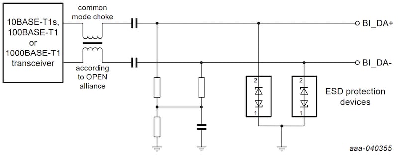

Application diagram of the PESD1ETH10L-Q
Application diagram of the PESD1ETH10L-Q.
The PESD1ETH10L-Q measures 1.0 mm x 0.6 mm x 0.48 mm while the PESD1ETH10LS-Q comes in a slightly smaller package of 1.0 mm x 0.6 mm x 0.37 mm. Both diodes are housed in surface-mounted plastic packaging with side wettable flanks. This casing protects devices in automotive in-vehicle network bus lines from ESD damage and other transients.
