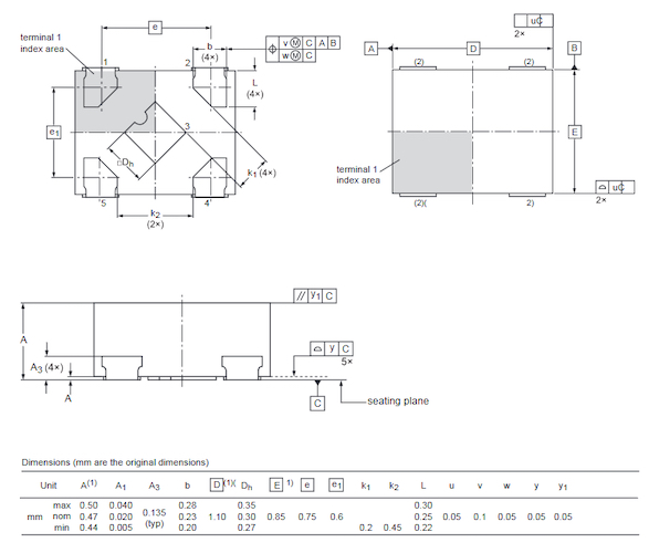

The SOT8065-1 MicroPak XSON5 features a thermally enhanced plastic enclosure, supporting the automotive industry's move from larger, traditionally leaded packaging to smaller leadless packaging.
SOT8065’s package outline
SOT8065’s package outline.
This transition aims to lower production costs and adapt to space-constrained applications. The SOT8065-1 features five terminals and measures 1.1 mm × 0.85 mm × 0.47 mm. Nexperia says that this provides a 68% PCB area saving compared to SOT353 leaded packaging while maintaining high quality. Nexperia also claims that the SOT8065-1-based devices suffer zero delamination and offer immunity to moisture up to MSL-1.
The RoHS and dark green compliant ICs also feature 7-μm Sn layers on their pads and bottom to reduce oxidation.

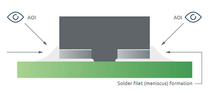

Side-Wettable Flanks for Optical Inspection
Another notable feature of the new packaging is its side-wettable flanks. Side-wettable flanks refer to terminal placements that improve manufacturing reliability by enabling automated optical inspection (AOI) to inspect solder joints.
Side-wettable flanks allow easy optical inspection
Side-wettable flanks allow easy optical inspection.
Typical IC terminal placement often requires X-ray-based machines to perform automated inspection of its solder joints. These set-ups are expensive to purchase and operate. Side-wettable flanks force solder filets along the side wall of the pads, allowing for visual inspection of solder joints. This means that manufacturers can utilize AOI to automate inspection while reducing costs.
