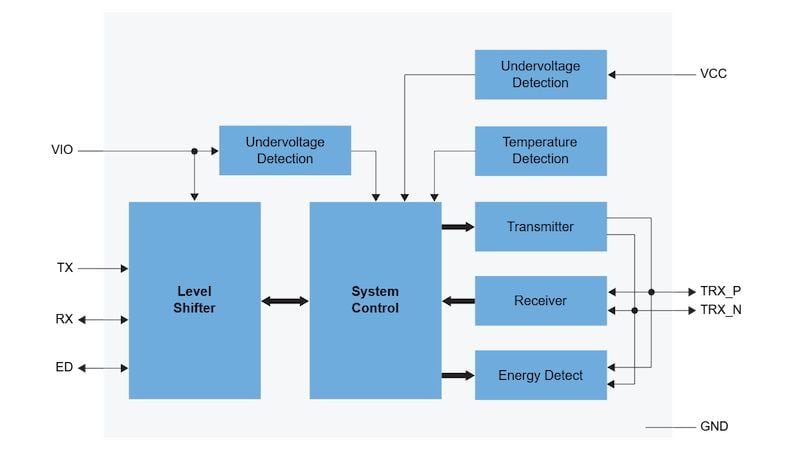

TJF1410 block diagram
TJF1410 system block diagram. Image used courtesy of NXP Semiconductors
NXP specifically designed the automotive-focused TJA1410 to meet ISO 26262 and ASIL B functional safety requirements. To that end, it supports Open Alliance TC14 topology discovery and TC10/TC14 remote wake-up over the Ethernet data line, enabling ECUs to transition between low-power and active states without dedicated wake-up wiring. The company also specifies robust EMC performance for in-vehicle environments and operation with lower-cost CAN FD common-mode chokes to reduce the bill-of-material cost.
For industrial and building automation, the TJF1410 is compliant with IEEE 802.3cg and OA TC14, including topology discovery and TC10/TC14 wake-up support. It supports multidrop bus configurations with up to 32 10BASE-T1S nodes and cable lengths up to 100 m. The device is also compatible with power-over-data line implementations and optimized for low quiescent current in low-power mode. Like the automotive variant, it comes in a 3 mm x 3 mm HVSON8 package to minimize PCB footprint.
