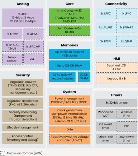

Block diagram of the MCX L
Block diagram of the MCX L.
In its lowest power mode, the MCX L series operates at sub-microamp levels. The ultra-low-power sense domain consumes only 1.85 µA during always-on operations, such as background data acquisition. With its real-time clock (RTC) enabled, power consumption is further reduced to approximately 0.7 µA. NXP also introduces an Adaptive Dynamic Voltage Control (ADVC) algorithm to facilitate power-saving features by dynamically adjusting the core voltage based on environmental conditions and workload demands.
“When you lower the voltage and approach near-threshold operation, any deviation can induce a malfunction,” Apfeldorfer said. “Our innovation lies in monitoring process speed, temperature, and chip aging to dynamically select the most reliable voltage, ensuring consistent performance while reducing energy by up to 50%.”
More information is availble on the joint product pages for the MCX L14x and L25x.
