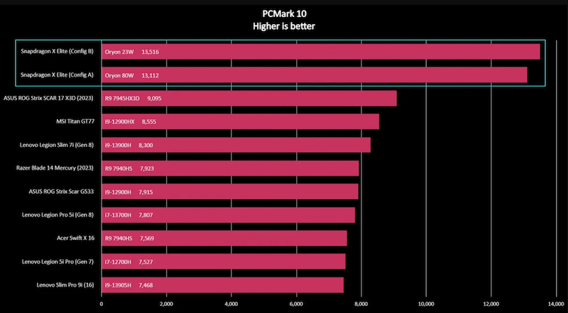

Snapdragon X Elite benchmarks
The Snapdragon X Elite reports improved computing performance compared to the competition, with the ability to run generative AI models in silicon. Image used courtesy of Future (Click to enlarge.)
Qualcomm has reported improved acceleration performance in both laptop and smartphone-based AI applications. Windows 11 on-device assistants reportedly used 30 tokens per second, while smartphones with the processor accomplished image generation in less than a second using Stable Diffusion.
During a live benchmarking session at Snapdragon Summit, Qualcomm demonstrated two laptop reference designs with different configurations to show off the power of Snapdragon X Elite. This demonstration and others proved that the chip uses a third of the power of Intel's highest-performing laptop CPU and outperforms an M2 processor in an Apple MacBook Pro 13" at 80 W peak.
