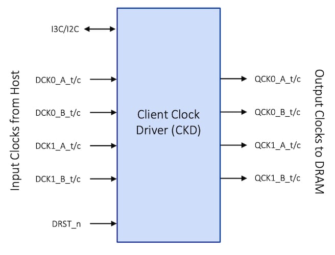

First, the Gen2 client clock driver (CKD02) buffers the clock signal between the host controller and the DRAM devices, supporting data rates up to 9,600 MT/s and clock frequencies up to 4,800 MHz. Rambus engineered the device to provide up to four differential output clock pairs, with single- and dual-PLL modes for flexible deployment. The CKD02 operates at 1.1 V and is housed in a 5.8 mm x 2.3 mm FPBGA package.

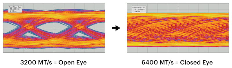

In conventional DDR4 and early DDR5 designs, the host controller drives the clock signal directly to each DRAM device on the module. But when engineers scale DDR5 above 6,400 MT/s, clock jitter, signal degradation, and timing instability accumulate along the traces between the host controller and each DRAM device on the module, resulting in extremely narrow timing margins. In response, the industry has embraced clocked memory modules (e.g., CUDIMM and CQDIMM for desktops, CSODIMM for laptops), which place a client clock driver on the module itself to condition and redistribute the clock before it reaches the DRAMs.
Increasing DDR5 data rates can deleteriously impact signal integrity
Increasing DDR5 data rates can deleteriously impact signal integrity. Image used courtesy of Tech4Tea
A client clock driver functionally intercepts the incoming clock, re-times it through an on-chip phase-locked loop (PLL), and distributes separate, conditioned clock pairs to each DRAM channel. Because the CKD sits on the module near the DRAM devices, the output trace lengths are short and tightly controlled. Meanwhile, the PLL absorbs jitter introduced earlier in the signal path before those contributions reach the DRAMs.
