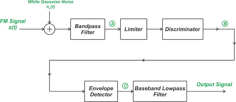

Shown in Figure 1 is the FM demodulator model typically used for noise analysis.
Figure 1. An FM receiver processing a noisy FM wave.
Using the above model, we analyze the transformation of both the input signal and noise components as they traverse various stages of the FM demodulator. Subsequently, we compute the output signal-to-noise ratio (SNR) to evaluate the performance quality of the FM receiver.

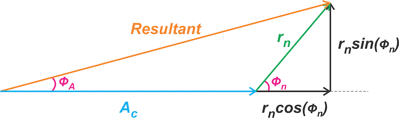

Phasor Representation for φ(t) = 0
As discussed in the previous article, we computed the output noise power under the assumption that no signal was present, i.e., ϕ(t) = 0. We now revisit that analysis using the phasor representation to build familiarity with this method before extending it to the more general case where ϕ(t) is non-zero. Assuming a carrier with no modulation and expressing the noise components in polar coordinates, Equation 7 simplifies to:
$$s(t) + n_{filtered}(t) = A_c cos (2 \pi f_c t) + r_{n}(t) \ cos \big (2 \pi f_c t + \phi_{n}(t) \big )$$
Equation 8.
where rn(t) and ϕn(t) are, respectively, the envelope and instantaneous phase of the noise. According to probability theory, the envelope rn(t) of the noise follows a Rayleigh distribution, while its instantaneous phase ϕn(t) is uniformly distributed over 2π radians. We’ll see how the uniformity of the phase distribution plays a key role in the next section. Shown below is the phasor form of the vector summation in Equation 8.
Figure 2.  Phasor diagram for unmodulated carrier wave plus noise.
The FM demodulator produces the derivative of the resultant vector’s phase angle ϕA. Thus, to understand the impact of noise, it’s necessary to derive an expression for ϕA. Assuming that the noise components rncos(ϕn) and rnsin(ϕn) are much smaller than the carrier amplitude Ac, we approximate the resultant vector’s phase as:
$$\phi_{A}(t) = tan^{-1} \Big( \frac{r_{n} sin(\phi_{n}))}{A_c + r_{n} cos(\phi_{n}))} \Big) \approx tan^{-1} \Big( \frac{r_{n} sin(\phi_{n}))}{A_c} \Big) \approx \frac{r_{n} sin(\phi_{n}))}{A_c}$$
Equation 9.
The term rnsin(ϕn) is equal to the quadrature component of the noise nQ(t), hence, ϕA(t) becomes:
$$\phi_{A}(t) \approx \frac{n_{Q}(t)}{A_c}$$
Equation 10.
Since the demodulator produces the derivative of ϕA(t), the noise component at the output (node C in Figure 1) is:
$$n_{C}(t) \approx \frac{1}{A_c} \times \frac{d}{dt}n_{Q}(t)$$
Equation 11.
Consistent with the results of the previous article, Equation 11 shows that the additive noise appearing at the output of the demodulator depends on the carrier amplitude and the quadrature component of noise. Moreover, the output noise appears independent of the message signal ϕ(t). However, it remains to be seen whether this outcome stems from assuming ϕ(t) = 0, or if it holds more generally. This question will be addressed in the following section.

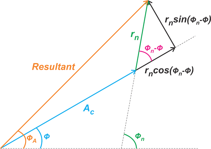

Phasor Representation With Non-Zero ϕ(t)
Without the simplifying assumption of ϕ(t) = 0, the carrier vector in Equation 8 acquires an initial phase of ϕ(t), which varies with the message as defined by Equation 2. In this case, we obtain the phasor diagram shown below.
Figure 3.  The phasor diagram of the noisy FM wave when ϕ(t) is
non-zero.
Figure 3. The phasor diagram of the noisy FM wave when ϕ(t) is non-zero.
Although the phasor diagram may initially appear complex, it simplifies upon closer inspection. To understand the construction of the phasor diagram, note that:
  1. The carrier phasor (blue) has a phase angle of ϕ(t)
  2. The noise vector (green) has a phase angle of ϕn(t)
  3. The phase angle of the resultant vector (orange) is denoted by ϕA(t). The objective is to compute the resultant phase angle ϕA(t).
By applying elementary geometric principles, the angle formed between the noise vector rn(t) and the continuation of the carrier vector is clearly ϕn(t) - ϕ(t). Now that we know the angle, we break down rn(t) into two components: one aligned with the carrier vector and the other orthogonal to it. From the phasor diagram, it’s straightforward to determine the resultant phase angle:
$$\phi_{A}(t) = \phi(t) + \tan^{-1} \bigg ( \frac{r_{n}sin \big ( \phi_n(t)-\phi(t) \big )}{A_{c} + r_{n}cos \big ( \phi_n(t) - \phi(t) \big )} \bigg)$$
Equation 12.
Assuming that the noise components are significantly smaller than the carrier amplitude most of the time, the above equation can be approximated as:
$$\begin{eqnarray} \phi_{A}(t) &\approx& \phi(t) + \tan^{-1} \bigg ( \frac{r_{n}\sin \big ( \phi_n(t)-\phi(t) \big )}{A_{c}} \bigg ) \\ &\approx& \phi(t) + \frac{r_{n}}{A_{c}} \times \sin \big ( \phi_n(t) - \phi(t) \big ) \end{eqnarray}$$
Equation 13.
This is the phase angle applied to the limiter in Figure 1. We know that the demodulator produces the derivative of ϕA(t). The derivative of the first term on the right-hand side of the above equation corresponds to the desired signal (refer to Equation 2), whereas the derivative of the second term introduces unwanted noise at the output. Accordingly, the noise component observed at the demodulator output (node C) becomes:
$$n_{C}(t) = \frac{1}{A_c} \times \frac{d}{dt} \bigg ( r_{n} \times sin \big ( \phi_n(t)-\phi(t) \big ) \bigg )$$
Equation 14.
The noise equation still remains relatively complex and further simplification is necessary before we can derive the SNR expression. We mentioned earlier that the phase ϕn(t) is uniformly distributed over 2π radians. What if the phase ϕn(t) - ϕ(t) were also uniformly distributed over 2π radians? In that case, the noise term defined in Equation 14 would be independent of the message signal, and in a statistical sense, we could substitute ϕn(t) - ϕ(t) with ϕn(t).
Since ϕn(t) has a uniform distribution over 2π radians, in the sense of ensemble averages, ϕn(t) - ϕ(t) differs from ϕn(t) only by a shift of the mean value. Therefore, we approximate Equation 14 as:
$$n_{C}(t) = \frac{1}{A_c} \times \frac{d}{dt} \bigg ( r_{n} \times sin \big ( \phi_n(t) \big ) \bigg ) = \frac{1}{A_c} \times \frac{d }{dt}n_{Q}(t)$$
Equation 15.
A comparison of Equations 11 and 15 reveals that the output noise expression remains unchanged, whether we assume ϕ(t) = 0 from the outset or retain it and later apply the mentioned simplifying assumptions. Therefore, when the noise components are significantly smaller than the carrier, the output noise of the FM system is independent of the message signal ϕ(t).
Before moving forward, if the preceding rationale for replacing ϕn(t) - ϕ(t) with ϕn(t) doesn’t fully convince you, I suggest consulting Section 6.2 of Fundamentals of Communication Systems by John G. Proakis, where you'll find an alternative, more detailed explanation.
