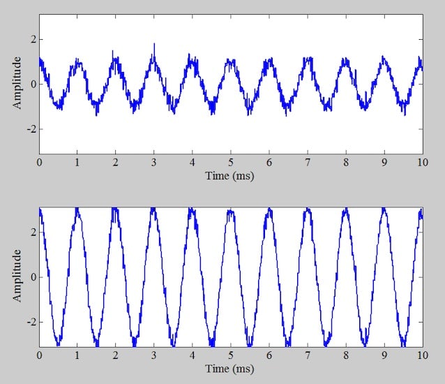

In FM signals, the message information is encoded in the instantaneous frequency of the carrier wave. That is, in the timing of its zero crossings. Additive noise superimposed on the signal can alter the zero crossings. Figure 1 provides some insight into how FM waves with different carrier amplitudes respond to noise.
Figure 1.  Impact of additive noise on FM waves with low (top) and
high (bottom) carrier power.
Figure 1. Impact of additive noise on FM waves with low (top) and high (bottom) carrier power.
The noise level is the same in both cases; however, the upper curve is generated with a smaller carrier amplitude than the lower curve. As observed, a low carrier amplitude makes zero crossings more vulnerable to noise, leading to a more corrupted FM waveform.
These example waveforms suggest that a higher carrier amplitude may offer greater immunity to noise, resulting in cleaner FM signal transmission. We’ll soon delve into the mathematical analysis to derive an expression for the FM system’s output signal-to-noise ratio (SNR). We’ll see that the mathematical analysis corroborates the intuition observed in Figure 1.
