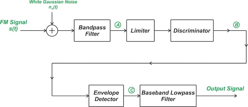

This is the second half of a two-part article on how additive white Gaussian noise affects FM signals in the basic case of tone modulation, where the message is a sinusoidal signal. Part 1 used the demodulator model shown in Figure 1 and derived the output signal power.
Figure 1. An FM receiver processing a noisy FM wave.

We now present an analysis of the noise transformation as it propagates through the demodulator. Initially, the input noise nw(t) passes through the pre-detection filter. The filtered noise nfiltered(t) at the output of the bandpass filter (node A) can be expressed in terms of its in-phase nI(t) and quadrature nQ(t) components:

The limiter eliminates the amplitude variations, making the multiplicative term rA(t) irrelevant for our noise analysis. As in the signal power computation, we set the amplitude term rA(t) to unity. We then take the time derivative of Equation 4 to determine the noise at the discriminator’s output:
$$n_{B}(t) = - \Big ( 2 \pi f_c - \frac{d \phi_{A}(t)}{dt} \Big ) \ sin \big (2 \pi f_c t - \phi_{A}(t) \big )$$
Equation 6.
Once we perform envelope detection and eliminate the DC term, we arrive at an expression for the noise at node C:
$$n_{C}(t) = \frac{d \phi_{A}(t)}{dt}$$
Equation 7.
nC(t) is the additive noise component that appears at node C in addition to the desired message signal. Now we combine ϕA(t) from Equation 5 with Equation 7 to find the output noise. To simplify the calculations, we assume that the noise components nI(t) and nQ(t) are much smaller than the carrier amplitude Ac. Using a small argument approximation, ϕA(t) becomes:
$$\phi_{A}(t) \approx \frac{n_{Q}(t)}{A_c}$$
Equation 8.
Finally, combining Equations 7 and 8, we derive an expression for the noise at node C:
$$n_{C}(t) \approx \frac{1}{A_c} \times \frac{d }{dt}n_{Q}(t)$$
Equation 9.
This shows that the additive noise appearing at the output of the envelope detector depends on the carrier amplitude and the quadrature component of noise. It does not depend on the message signal. Furthermore, Equation 9 shows that the output noise is suppressed if the transmitted signal amplitude Ac is increased.

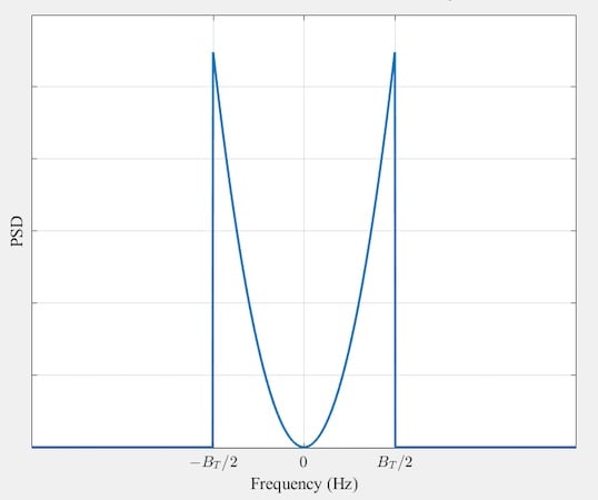

Using Equation 18, the power spectral density of nC(t) is as shown in Figure 3 below.
Figure 3. Power spectral density of noise at the output of the
envelope detector.
Figure 3. Power spectral density of noise at the output of the envelope detector.
The parabolic shape of the noise spectrum results from the differentiating action of the FM discriminator and has a profound effect on the performance of FM systems operating in the presence of noise.

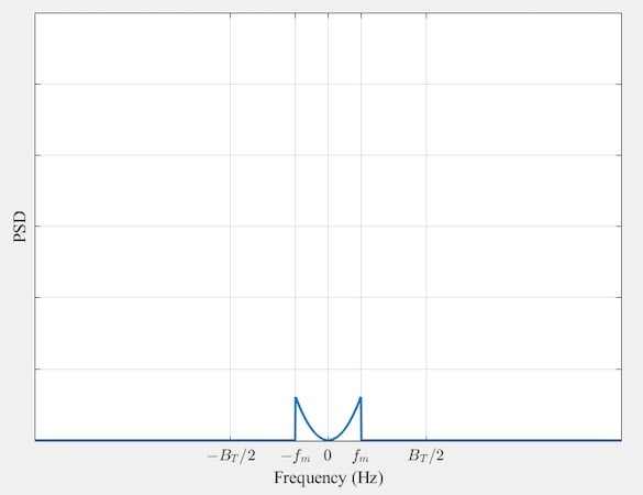

If the message bandwidth is W, we usually use a lowpass filter with bandwidth W at the output. Commonly, W is smaller than BT/2. This leads to the following noise power spectral density at the output of the lowpass filter.
$$S_{n_{o}} (\omega) = \frac{\omega^2}{A_c^2} \times N_0 \quad for \quad |f| \leq W$$
Equation 11.
Figure 4 shows the noise power spectral density at the output of the baseband lowpass filter for the tone-modulated case (W = fm).
Figure 4. The power spectral density of noise at the output of the
post-detection filter.
Figure 4. The power spectral density of noise at the output of the post-detection filter.
The average output noise power is obtained by taking the integral of the corresponding power spectral density over -ωm to +ωm:
$$P_{n,out} = \frac{1}{2 \pi} \int_{- \omega_m}^{+ \omega_m} S_{n_o} (\omega) \ d \omega = \frac{N_0 \omega_m^3}{3 \pi A_c^2}$$
Equation 12.
Note that the average output noise power is inversely proportional to the square of the carrier amplitude Ac2. Therefore, increasing the carrier power has a noise-quieting effect.
