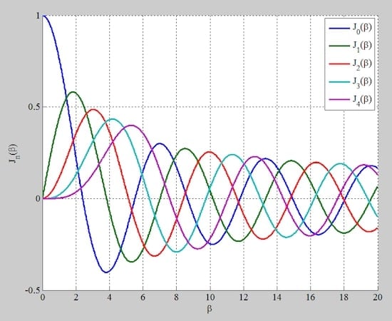

Figure 3 shows Jn(β) for n = 0 through 4 and β ≤ 20.
Bessel functions of the first kind for n equals zero through four and β less than or equal to twenty.
Figure 3. Bessel functions of the first kind for n = 0 through 4 and β ≤ 20.
With β = 0, Figure 3 shows that we have J0(0) = 1 and Jn(0) = 0 for all n > 0. In this case, we have no modulation. Only the unmodulated carrier, which has a relative amplitude of unity, appears at the output. This is illustrated in Figure 4(a).
