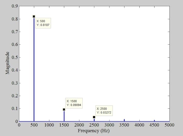

To determine W, we'll examine the spectrum of the triangle-wave message signal in Figure 3. This spectrum is shown in Figure 4.
The single-sided spectrum of the message signal.
Figure 4. The single-sided spectrum of the message signal.
The fundamental frequency is 500 Hz, with higher harmonics dropping off rapidly. For example, the fifth harmonic at 2,500 Hz has an amplitude that's just 4% of the fundamental, resulting in a power that's only 0.16% of the fundamental power.
Let's assume that the third harmonic is the highest significant frequency component of the signal (W = 1,500 Hz). Noting that the maximum value of m(t) is unity, Equation 20 produces:
