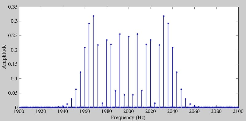

Figure 1 shows the typical spectrum of a tone-modulated FM wave when the carrier wave has an amplitude of unity.
Typical spectrum of an FM signal for a single-tone message signal.
Figure 1. Typical spectrum of an FM signal for a single-tone message signal.
The spectrum includes distinct tones separated by the modulating frequency (fm). These tones are found at the carrier frequency (fc) and sideband frequencies fc ± fm, fc ± 2fm, fc ± 3fm, and so on. The amplitude of the nth sideband is scaled by the Bessel function of the first kind, Jn(β), where β represents the modulation index.
