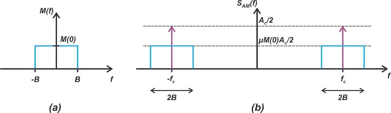

Example: Comparing Narrowband Angle-Modulated and AM Spectra
To get a sense of the spectra generated by narrowband FM and PM waves, let’s consider the message signal spectrum in Figure 1(a). This spectrum corresponds to a sinc function in the time domain.
The spectrum of a sinc message signal (a) and of the corresponding conventional AM wave (b).
Figure 1. The spectrum of a sinc message signal (a) and of the corresponding conventional AM wave (b).
Applying Equation 7 to this message signal produces a conventional AM wave, the spectrum of which is illustrated in Figure 1(b). Next, let’s find the spectra generated by narrowband PM and FM schemes.

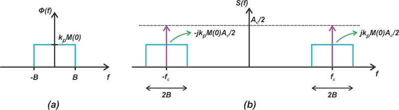

The Narrowband PM Spectrum
Figure 2(b) shows the spectrum of the PM wave corresponding to Figure 1(a)’s message signal. The spectrum of ϕ(t), as per Equation 2, is shown in Figure 2(a).
The spectrum of the phase deviation for the PM scheme (a) and the spectrum of the phase-modulated wave (b).
Figure 2. The spectrum of ϕ(t) for the PM scheme (a) and the spectrum of the PM wave for the sinc message signal (b).

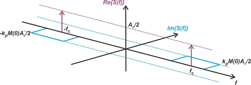

Comparing Figure 2(b) with Figure 1(b), we observe that both spectra have impulse functions at ±fc and contain replicas of the message spectrum. However, the narrowband PM spectrum is multiplied by the factor j for frequencies greater than zero and by –j for f < 0.
The factors ±j indicate a phase shift of 90 degrees with respect to the carrier frequency. The carrier has a real value because it’s contained in the in-phase component of Equation 6. By contrast, the message information has a complex value because it resides in the quadrature component.
The 3D diagram in Figure 3 provides a more accurate representation of the spectrum in Figure 2(b).
3D representation of the PM wave’s spectrum.
Figure 3. A 3D representation of the example PM wave’s spectrum.

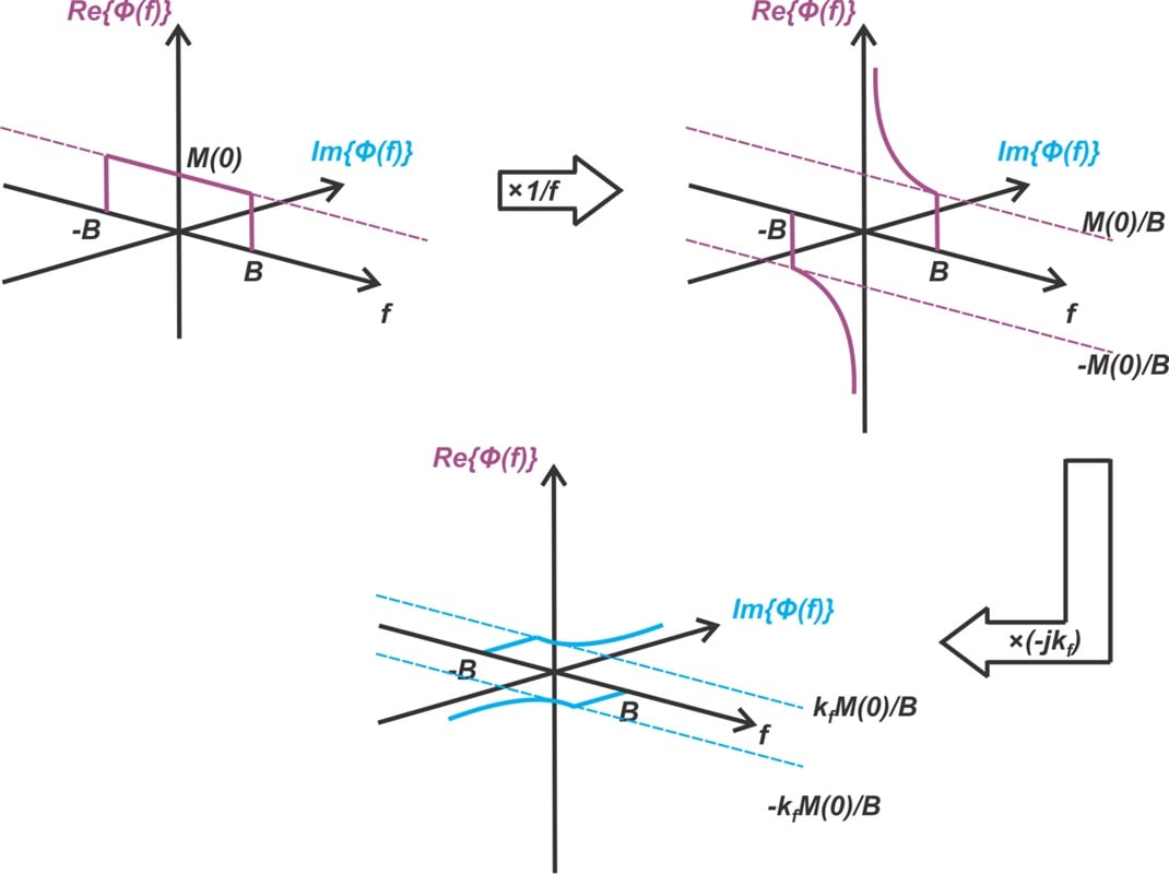

To find the narrowband FM spectra, we first determine the spectrum of ϕ(t) by applying a Fourier transform to Equation 3. Using the integration property of the Fourier transform, we obtain:
$$\begin{eqnarray}\Phi (f) &~=~& 2 \pi k_f ~\times~ \mathcal{F} \Big [ \int_{-\infty}^{t} m(\tau) \ d \tau \Big ] \\&~=~& 2 \pi k_f ~\times~ \frac{1}{j 2 \pi f} ~\times~ M(f) \\&~=~& - \frac{j k_f}{f} ~\times~ M(f)\end{eqnarray}$$
Equation 11.
Note that the Fourier transform of the integral of a function generates an impulse function. For the sake of simplicity, this impulse function is disregarded in the above equation.
Figure 4 illustrates the derivation of Φ(f) from M(f) according to Equation 11.
3D illustration of the frequency-domain spectrum for the FM wave.
Figure 4. The spectrum of Φ(f) for the FM scheme, illustrated in 3D. [click to enlarge]

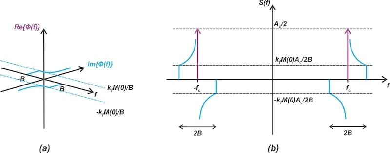

Due to the integration, the spectrum of Φ(f) takes the form of a truncated hyperbola in the imaginary plane. When the narrowband angle modulation equation is applied, this imaginary component is multiplied by the factor Ac/2j, converting it back into a real component. We then obtain the narrowband FM spectrum depicted in Figure 5(b).
The spectrum of the phase deviation for the FM scheme (a) and the spectrum of the narrowband FM wave itself (b).
Figure 5. The spectrum of ϕ(t) for the FM scheme (a) and the spectrum of the narrowband FM wave (b).
Because the imaginary components of Φ(f) revert to a real component when the narrowband FM equation is applied, I used a 2D diagram to represent the final spectrum.

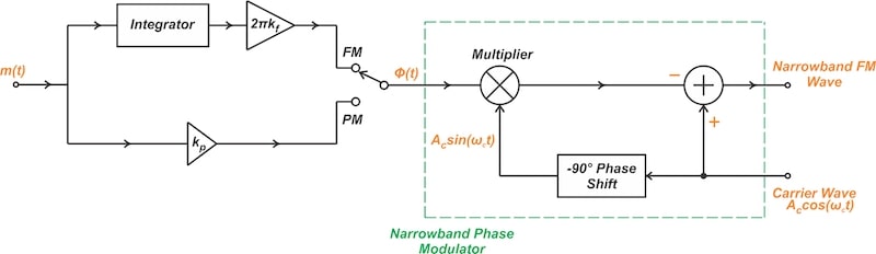

A Circuit for Generating Narrowband Angle-Modulated Signals
An important implication of Equation 6 is that it suggests a method for generating narrowband angle-modulated waves through the use of analog multipliers and summers. The block diagram for this circuit is shown in Figure 6.
Block diagram of a circuit for generating narrowband angle-modulated signals.
Figure 6. Block diagram of a circuit for generating narrowband angle-modulated signals.
In a future article, we’ll see that the above circuit serves as a fundamental building block for generating wideband angle-modulated signals. This is achieved through a process known as narrowband-to-wideband conversion.
