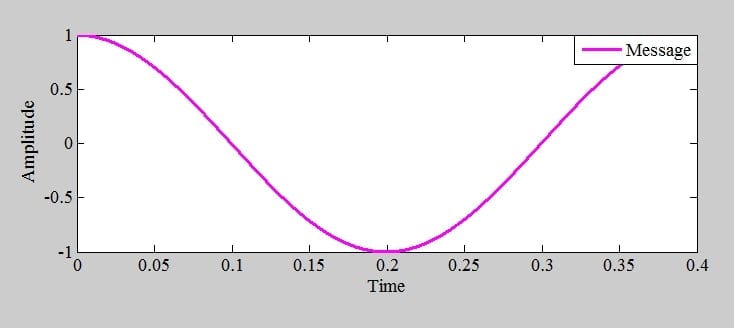

Test Your Knowledge: Another Sinusoidal Message Signal
After checking out the waveforms above, you're practically a PM pro! Let's use the sinusoidal message signal in Figure 5 to see how well you know your stuff.
A sinusoidal message signal for generating a PM wave.
Figure 5. A sinusoidal message signal for generating a PM wave.
We know that phase modulation may show up as a change in the frequency of the modulated signal. Which segments of the waveform above will result in the highest output frequencies, and which the lowest?
Figure 6 shows the PM wave obtained by modulating an 80 Hz carrier signal with kp = 25 rad/V.
The message signal (top) and the corresponding PM wave (bottom).
Figure 6. The message signal (top) and the corresponding PM wave (bottom).
Note the cursor box at the bottom left of the figure. By considering this data point, we observe that half the period of the first cycle is about 0.0068 seconds. This corresponds to a frequency of about 73.5 Hz, which is close to the frequency of the unmodulated carrier (fc = 80 Hz). Therefore, around the message waveform’s peak, the PM wave exhibits a frequency close to the unmodulated carrier.
To understand this, note that the peak of the sinusoidal wave has a very small slope (almost zero). The output frequency is therefore fc, just as was the case for the flat regions of the message waveform in Figure 4.
Conversely, the descending part of the sinusoidal wave shows its steepest negative slope when it crosses zero around t = 0.1 seconds. This region generates the lowest output frequency. Around t = 0.2 seconds, the slope of the message waveform again approaches zero, producing an output frequency almost equal to the unmodulated carrier frequency.
Finally, as the rising part of the waveform crosses the zero level, it reaches its steepest positive slope, resulting in the maximum output frequency. This is clearly illustrated in Figure 7, which offers a close-up view of the relevant region.
The ascending part of the message signal (top) and the corresponding PM wave (bottom) during the rising part of the message waveform.
Figure 7. The ascending part of the message signal (top) and the corresponding PM wave (bottom) during the rising part of the message waveform.
