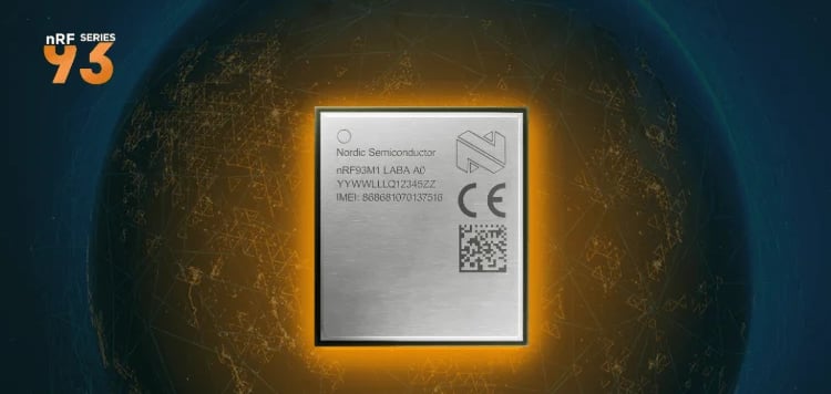

At the show, Nordic also introduced the nRF93 series, which targets higher-throughput cellular IoT deployments using LTE Cat 1 bis connectivity. The nRF93M1 supports up to 10 Mbps downlink and 5 Mbps uplink while maintaining Nordic’s low-power design approach. The module also integrates Wi-Fi location capabilities and direct compatibility with nRF Cloud, enabling features such as firmware-over-the-air updates, device monitoring, and remote debugging.

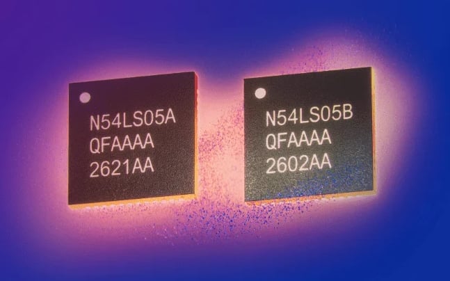

nRF54LS05A and nRF54LS05B: Entry-Level Bluetooth LE SoCs
Nordic also expanded its nRF54L series, introducing two entry-level Bluetooth Low Energy SoCs: the nRF54LS05A and nRF54LS05B. The company designed these chips for cost-sensitive wireless products while still leveraging its established Bluetooth ecosystem and development tools.
Nordic’s nRF54LS05A and nRF54LS05B SoCs
Nordic’s nRF54LS05A and nRF54LS05B SoCs combine a Cortex-M33 processor with a Bluetooth LE radio for compact, low-power wireless designs. Image used courtesy of Nordic Semiconductor
Both devices combine a 128-MHz Arm Cortex-M33 processor with Nordic’s fourth-generation Bluetooth LE radio, making them suitable for applications such as sensors, tags, beacons, remotes, and PC peripherals. The two variants share 0.5 MB of non-volatile memory, with the LS05B providing 96 KB of RAM compared with 64 KB in the LS05A—giving developers slightly more memory headroom for additional features.

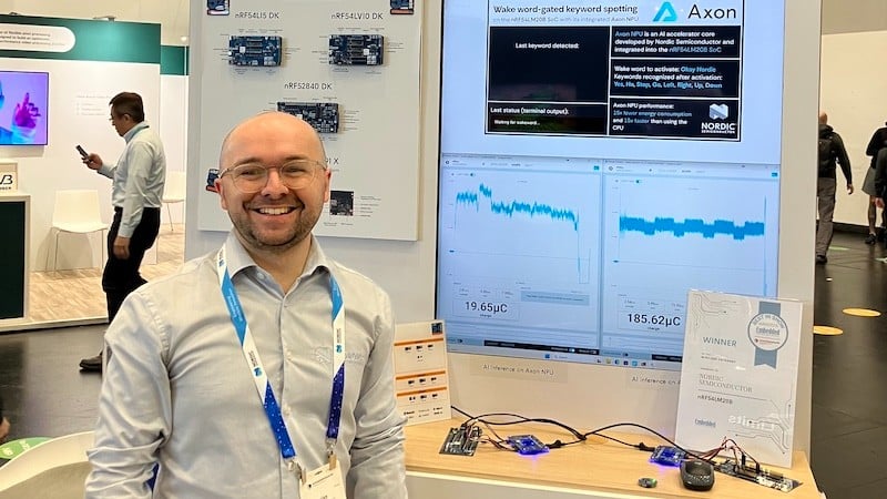

At Embedded World, we spoke to Sam Presley, technical product manager at Nordic Semiconductor, about the new nRF54LM20B.
At Embedded World, Nordic’s Sam Presley spoke All About Circuits about the nRF54LM20B. The SoC integrates Nordic’s Axon NPU to enable real-time edge AI processing directly on battery-powered devices.
At Nordic's Embedded World booth, Sam Presley spoke to All About Circuits about the nRF54LM20B. The SoC integrates Nordic’s Axon NPU to enable real-time edge AI processing directly on battery-powered devices.
“The SoC is integrating a Nordic proprietary core called Axon, and this is an NPU,” said Presley. “This means it's an AI acceleration engine that we have in hardware. We can use it to accelerate AI inference algorithms on the chip. It can do it faster and with less energy than if you were running it on the CPU.”
Presley showed us a demo running the same algorithm on both the Arm Cortex CPU and on the Axon NPU on the same device.
“You can see here it's like a 10-second reduction in power consumption,” said Presley. “This is really exciting because it's going to enable customers to build some really interesting applications with these devices. We've got a demo here where you can do word recognition. You can say, ‘Okay Nordic,’ ‘Yes,’ ‘No,’ ‘Stop,’ or ‘Go,’ and it will recognize and act on those words.”
The nRF54LM20B SoC also received industry recognition at Embedded World 2026, where it won the Embedded Computing Design “Best in Show” Award (see image above—award in lower left-hand corner). The award was given to highlight the chip’s combination of ultra-low-power wireless connectivity and integrated edge AI acceleration, which judges cited for its design innovation and potential impact on embedded systems.
