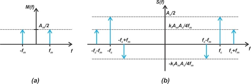

Consider the narrowband FM wave corresponding to the following message signal:
$$m(t)~=~A_m \cos(2 \pi f_m t)$$
Equation 5.
Applying Equation 3, ϕ(t) is found to be:
$$\phi(t) ~=~ \frac{k_f A_m}{ f_m} \sin( 2 \pi f_m t)$$
Equation 6.
By combining Equations 4 and 6, we obtain the modulated signal:
$$s(t) ~\approx~ A_c \cos( 2 \pi f_c t) ~-~ \frac{k_f A_m A_c}{ f_m} \sin( 2 \pi f_m t) \sin(2 \pi f_c t)$$
Equation 7.
which, using a standard trigonometric identity, can be rewritten as:
$$s(t) ~\approx~ A_c \cos( 2 \pi f_c t) ~+~ \frac{k_f A_m A_c}{2 f_m} \Big [ \cos \big ( 2 \pi (f_c~+~f_m) t \big ) ~-~ \cos \big (2 \pi (f_c ~-~ f_m) t \big ) \Big ]$$
Equation 8.
The first term in the above equation produces two impulses at ±fc, which means that the carrier is present at the output spectrum. The terms inside the square brackets produce impulses at all of the following frequencies:
  • fc + fm
  • –(fc + fm)
  • fc – fm
  • –(fc – fm)
The output spectrum is shown in Figure 1(b).
The spectra of the single-frequency modulating input (a) and the corresponding narrowband FM signal (b).
Figure 1. The spectra of the single-frequency modulating input (a) and the corresponding narrowband FM signal (b).

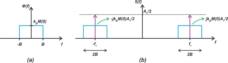

Note that the above equation matches the definition of phase modulation. Assuming that |ϕn(t)| is much less than 1 radian, we can apply our insights from the narrowband angle-modulation discussion to the phase noise phenomenon. For instance, considering the close relationship between PM and FM schemes, Equation 14 implies that the frequency of oscillation slightly deviates from its ideal value.
Also, for |ϕn(t)| ≪ 1, the spectrum of vosc(t) comprises an impulse function at fc and a replica of the spectrum of ϕn(t) translated to a center frequency of fc. Figure 5 provides an illustrative but perhaps unrealistic example, showing how a replica of the spectrum of ϕn(t) is translated to a center frequency of fc.
The spectrum of the phase noise (a) and the oscillator output (b).
Figure 5. (a) The spectrum of ϕn(t) and (b) that of the oscillator’s output.
Above, Figure 5(a) above shows the spectrum of ϕn(t). Figure 5(b) depicts the spectrum of the oscillator’s output assuming that the narrowband condition is satisfied. A more realistic example of an oscillator spectrum is illustrated in Figure 6.

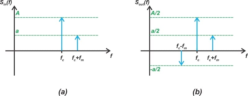

The input applied to the circuit consists of a large sinusoid of amplitude A at fc and a smaller sinusoid of amplitude a at fc + fm. This is illustrated in Figure 8(a).
The spectrum of the input applied to the differential pair (a) and the output spectrum (b).
Figure 8. The spectrum of the input applied to the differential pair (a) and the output spectrum (b).
Assume that A is large enough to make the differential pair act as a hard limiter, resulting in two distinct output levels at any given time. In other words, A is large enough to steer ISS completely to one branch of the differential pair at any given time. Explain why the output spectrum should consist of three components at fc and fc ± fm, with sidebands exhibiting opposite signs as shown in Figure 8(b).
Hint: Note that the input can be expressed as a combination of an AM wave and an FM wave. Additionally, consider how a hard limiter responds to each type of AM and FM signals.
