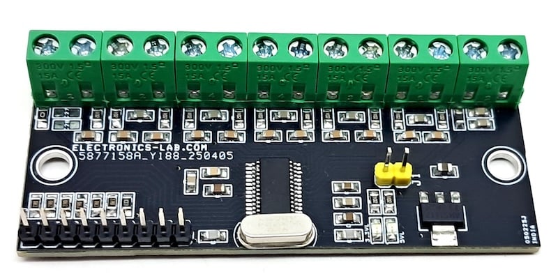

Figure 1. The assembled 10-Channel 32-Bit ADC Converter board, built
around the ADS1262.
Figure 1. The assembled 10-Channel 32-Bit ADC Converter board, built around the ADS1262.
The ADS1262 provides 11 analog input pins: AIN0 through AIN9, plus a common input (AINCOM). These can be configured as up to five differential input pairs, ten single-ended inputs referenced to a common voltage, or a mix of both. A flexible input multiplexer routes any two inputs to the ADC's positive or negative input. Any AINx pin can also serve as a common input for single-ended measurements. AINCOM is purpose-built for this role, since it can supply a bias voltage to level-shift floating sensors into the PGA's common-mode range. All analog inputs are broken out to screw terminals on the board, with supporting filter and ratiometric circuitry for a variety of sensor types. Figure 1 shows the assembled board.

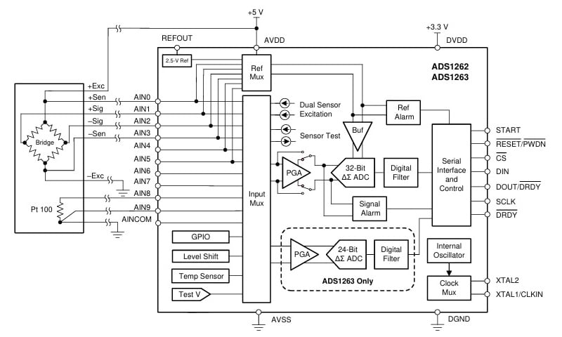

The ADS1262 multiplexes its 11 analog inputs to the 32-bit primary ADC. The ADS1263 variant can also route them to an auxiliary 24-bit ADC. This lets a single device service up to five differential sensor channels or ten single-ended channels referenced to AINCOM.
Many of the input pins are multifunction. AIN0–AIN5 can serve as external reference inputs. All analog inputs can source the dual sensor-excitation currents (IDAC1 and IDAC2), each programmable from 50 µA to 3000 µA for biasing RTDs and thermistors. AINCOM provides the VBIAS level-shift function for single-supply operation. AIN3 through AINCOM also double as eight general-purpose I/O lines referenced to the 5 V analog supply.
An internal test DAC (TDAC) outputs known positive and negative voltages on AIN6 and AIN7 to diagnose the signal chain. These pins should not be loaded while the test signals are enabled, since the TDAC outputs are unbuffered.
A 7.3728 MHz crystal (X1) clocks the ADS1262's internal oscillator. An LM1117 3.3 V regulator (U2) derives the digital-side supply from the 5 V analog rail. Jumper J1 selects whether the two supplies are combined or separated.
Figure 2. Temperature-compensated bridge measurement example using the
ADS1262 showing the input multiplexer, PGA, dual ΔΣ ADCs, and support
functions.
Figure 2. Temperature-compensated bridge measurement example using the ADS1262 showing the input multiplexer, PGA, dual ΔΣ ADCs, and support functions. Image used courtesy of Texas Instruments

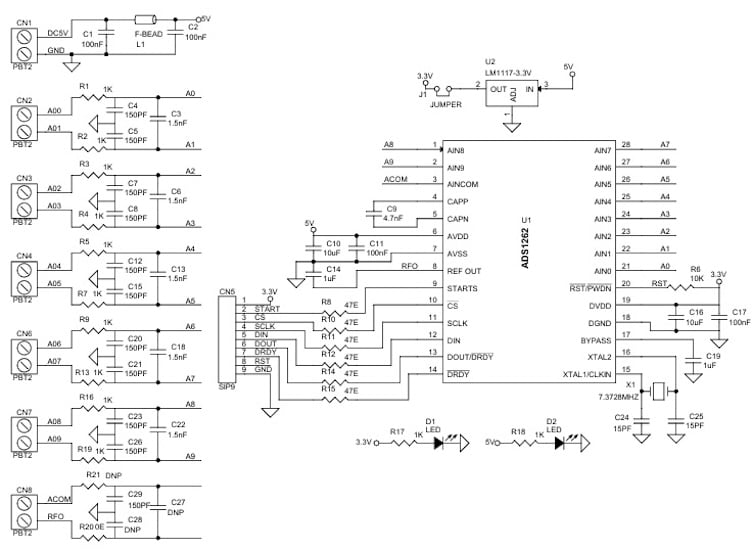

The full schematic for the 10-Channel 32-Bit ADC Converter is shown in Figure 3.
Figure 3. Schematic of the 10-Channel 32-Bit ADC Converter board.
The bill of materials is shown in Table 1.
Table 1. BOM for the 10-Channel 32-Bit ADC Converter.

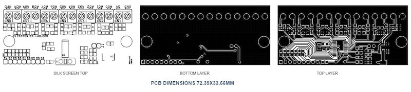

The PCB measures 72.39 mm x 33.66 mm. The silk screen, top layer, and bottom layer are shown in Figure 5.
Figure 5. PCB layout for the 10-Channel 32-Bit ADC Converter, showing
silk screen, top layer, and bottom layer.
Figure 5. PCB layout for the 10-Channel 32-Bit ADC Converter, showing silk screen, top layer, and bottom layer.
You can download the layout files for this project here:
Data Acquisition Module Gerber Files
