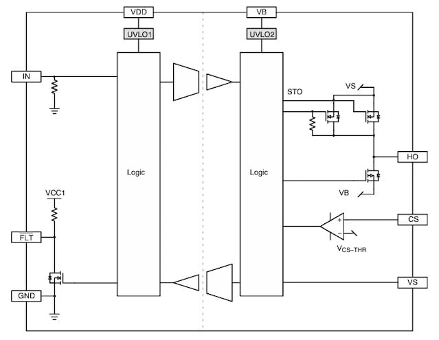

The NCD57085 is a single-channel IGBT gate driver with 2.5 kVrms internal galvanic isolation, packaged in a narrow-body SOIC-8. It accepts logic-level inputs from 3.3 V to 20 V and drives the gate with up to ±7 A peak current, enabling fast switching of high-power IGBTs. A simplified block diagram is shown in Figure 2.
Figure 2. Simplified block diagram of the NCD57085 gate driver IC.
Figure 2. Simplified block diagram of the NCD57085 gate driver IC. Image used courtesy of onsemi
Overcurrent protection is handled through the current sense (CS) pin. A 22 mΩ/3 W shunt resistor (R14, SMD size 2512) is placed in the IGBT emitter path. When the voltage across the shunt exceeds the 250 mV internal threshold, the driver performs a soft turn-off to limit stress on the IGBT, and pulls the fault output low. The shunt resistor value can be selected based on the application’s maximum allowable load current. A 1% tolerance resistor in size 4527 or 2512 is recommended.

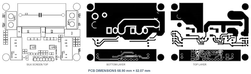

The PCB layout is shown in Figure 5. Gerber files for fabrication are available for download below.
Figure 5. PCB layout: silk screen top, bottom layer, and top layer.
Dimensions: 68.90 × 52.07 mm.
Figure 5. PCB layout: silk screen top, bottom layer, and top layer. Dimensions: 68.90 × 52.07 mm.
