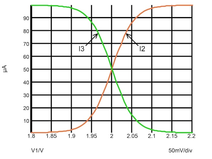

Two transistors—in this case, bipolar—share a common emitter current. If the voltages at their bases are equal and the two transistors match perfectly, I1 is split into two equal parts, I2 and I3, at the collectors.
If we increase V1 relative to V2, Q1 gets more of the current than Q2. If we decrease V1, the opposite is true.

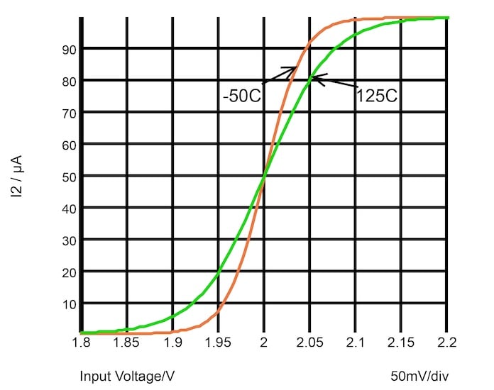

As the current moves from one transistor to the other, both emitter resistances change. We then get some rather nonlinear behavior, as Figure 5-2 shows. Only a small portion of the curve in the middle, when the two currents are equal or nearly equal, could be called linear. In truth, though, that portion isn’t a straight line either.
I-V curve for a bipolar differential pair
Figure 5-2. The conversion from input voltage to current (the transconductance) is nonlinear.
Temperature Effects
The other variable in the equation is temperature. The emitter resistance is proportional to absolute temperature, so at high temperatures, you get less gain or transconductance. This is illustrated in Figure 5-3.
Temperature dependence of the I-V curve for a bipolar differential
pair
Figure 5-3. The differential pair transconductance is also temperature-dependent.

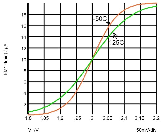

This transconductance is also nonlinear. As illustrated in Figure 5-5, it increases drastically with increasing gate voltage.
I-V curve for a MOSFET differential pair
Figure 5-5. A CMOS differential pair is also non-linear.
In the bipolar transistor, size is only of second-order importance. In an MOS transistor, however, transconductance is directly proportional to gate width and decreases with increasing temperature (Figure 5-6).
Temperature dependence of the I-V curve for a MOSFET differential
pair
Figure 5-6. The CMOS differential pair transconductance also has a temperature coefficient.
