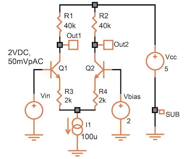

Even with only 50 mV peak input, there is already significant distortion—about 5%. We can improve this by connecting resistors in series with each emitter. The new resistors are labeled as R3 and R4 in Figure 5-8.
Circuit schematic of a bipolar differential pair amplifier with
emitter resistors
Figure 5-8. Linearized differential amplifier using emitter resistors.
This makes the total emitter resistance more linear, which drops the distortion to less than 0.1% (with a 50 mV peak input). However, the gain suffers badly—it’s less than 16 with a differential output. Single-ended, it’s less than 8.

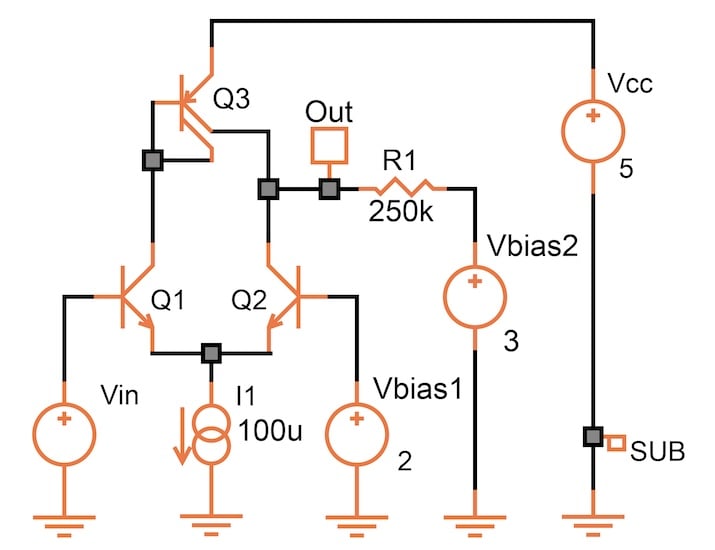

To get more gain, we need a better scheme for the output. In the vast majority of applications, an amplifier needs only one output. It’s, therefore, no loss if we convert the differential signal to a single-ended one in the very first stage. If we use a current mirror (Figure 5-10), the benefits are immediate.
Circuit schematic of a bipolar differential pair amplifier with active
load
Figure 5-10. Differential amplifier with an active load.
Q3 is called an active load. If one NPN collector current is mirrored by Q3 (here, a split-collector lateral PNP), it opposes the current of the second collector. With no input signal and perfect matching, the two currents are equal. With an input signal, though, one current increases while the other one decreases (hopefully by the same amount) so that we only see their difference at the output. We can, therefore, use a much larger output resistance.
As drawn, the gain of this stage is 278. This large gain produces a large output signal with only 1 mV-peak at the input. As seen in Figure 5–11, this makes the distortion reasonably small.
Sinusoidal signal output from a bipolar differential pair amplifier
with active load
Figure 5-11. Output signal with a 1 mVp sine-wave input.
However, there are two things wrong with the circuit in Figure 5-10. First, if you were to specify a 250 kΩ resistor in an IC, you might be suspected of lunacy—its size would take up more space than all the other components combined.
Second, if you look at the output waveform closely, you’ll notice that there’s a DC current flowing through R1. At the right end, we connect R1 to a 3 V bias point, but at the left end, the center of the sine wave is not 3 V but 3.25 V, meaning we have a built-in offset. There are two reasons for this:
  1. The two collectors of Q3 are not at the same potential.
  2. The collector current of Q1 has to supply the base current for Q3.
We need something like R1 to fix the DC potential at the output. The two opposing collectors are current sources/sinks. The smallest difference between the two would cause the output potential to move up so much that Q3 would saturate or down so much that Q2 would saturate.
