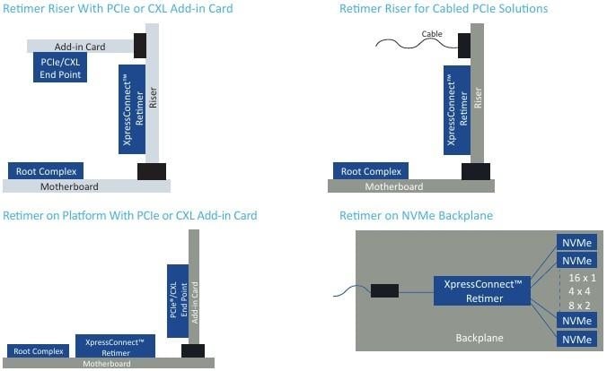

Typical applications for the new Microchip Retimer along with other Microchip datacenter support components (in blue)
The retimer is an increasingly necessary component within enterprise servers. It improves operation within nonvolatile memory express (NVMe) PCIe enclosures and Flash arrays, CXL memory sections, and PCIe fabrics. More information is available in the PM8691 Fact Sheet.
