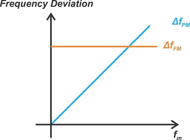

Example 4: Determining the Frequency Multiplication Factor for FM and PM Waves
Imagine a circuit that produces a narrowband angle-modulated wave with a frequency deviation of Δf1 = 50 Hz when a 120 Hz single-tone message signal is used. The message signal has an amplitude of unity. A frequency multiplier is used after the narrowband generator to enhance the maximum frequency deviation.
Our goal is to generate a maximum frequency deviation of 20 kHz at the output of the multiplier when the message frequency applied to the narrowband generator is 240 Hz. What is the required multiplication factor if frequency modulation is used to generate the narrowband signal? What about if phase modulation (PM) is used?
Solution
To solve this example, we need to understand how the frequency deviations of FM and PM waves vary with the frequency of the message signal. In an FM scheme, the frequency deviation remains unaffected by the modulating frequency (fm); in PM, it's directly proportional to fm. This relationship, which we discussed at length in an earlier series, is illustrated in Figure 5.
The impact of message frequency on the frequency deviation of FM (orange) and PM (blue) schemes.
Figure 5. The impact of message frequency on the frequency deviation of FM (orange) and PM (blue) schemes.
First, let's assume that frequency modulation is used to generate the narrowband signal. In this case, the frequency deviation at 240 Hz is identical to that at 120 Hz, which, according to the problem specifications, is Δf1 = 50 Hz. To increase the frequency deviation from 50 Hz to 20 kHz, we need a frequency multiplication factor of 400.
If the narrowband signal is a PM wave, then the frequency deviation is directly proportional to the message signal frequency. This means that the ratio of the frequency deviations at two different message frequencies is equal to the ratio of the frequencies. If Δf2 is the frequency deviation at a message frequency of fm2 = 240 Hz, we have:
$$\frac{\Delta f_2}{\Delta f_1} ~=~ \frac{f_{m2}}{f_{m1}} \quad \Rightarrow \quad \Delta f_2 ~=~ \frac{240}{120} ~\times~ 50 ~=~ 100 \ \text{Hz}$$
Equation 20.
In this case, a frequency multiplication factor of 200 is required to increase the frequency deviation from 100 Hz to 20 kHz.
