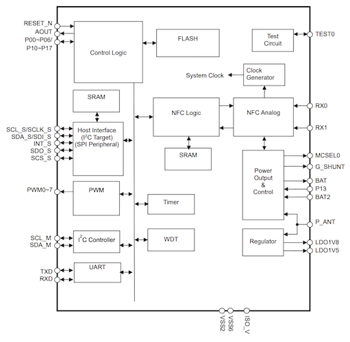

ROHM’s ML7670 receiver IC
Rohm's ML7670 receiver IC is designed for ultra-compact wearable devices where space and antenna size are heavily constrained.

Block diagram of the ML7670
Block diagram of the ML7670.

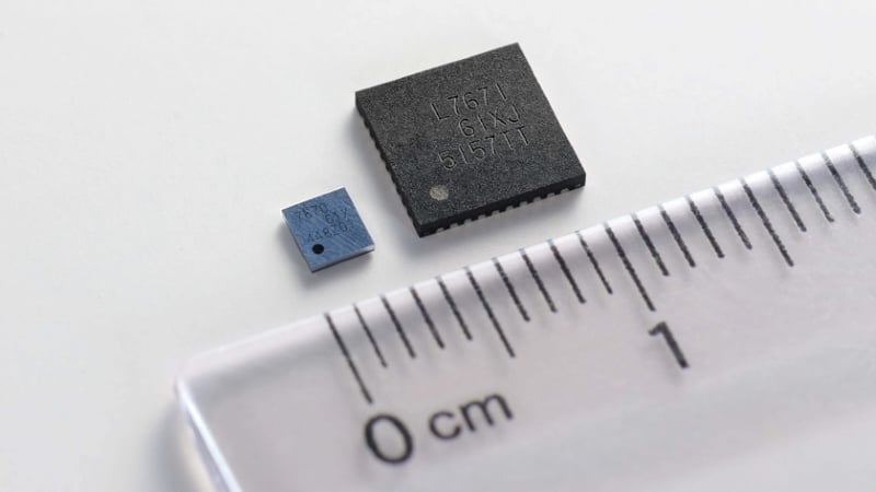

Rohm designed its new chipset specifically around that constraint. The ML7670 receiver supports up to 250 mW of wireless power transfer while fitting into a compact 2.28 mm × 2.56 mm WL-CSP package. The transmitter side, ML7671, handles wireless power delivery and communication while operating directly from a 5-V USB power source. The company says the receiver achieves up to 45% power transfer efficiency in the 250-mW range, which is important in wearables where thermal limits and battery size leave little room for wasted power.

Switching MOSFETs used for supplying power to charging circuits are built in, along with charging control functions, LDO support, communication control, and monitoring features.

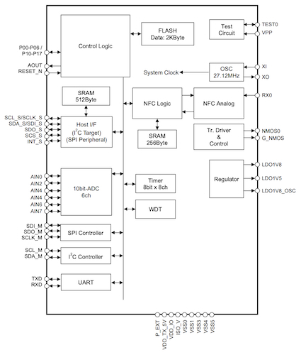

Block diagram of the ML7671
Block diagram of the ML7671.
The receiver also integrates a 10-bit SAR ADC for power monitoring along with NFC communication capabilities. On top of that, the chipset supports NFC Forum Type F technology, enabling functions such as Bluetooth pairing through touch-based interaction. All of that reduces board complexity in devices with extremely limited PCB space.

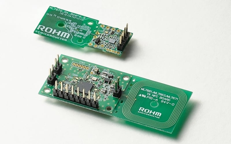

Rohm’s evaluation boards
Rohm’s evaluation boards demonstrate the compact NFC wireless charging architecture used for integrating receiver and transmitter ICs into small wearable devices.
