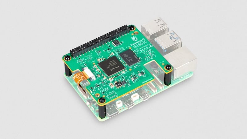

Raspberry Pi recently introduced the AI HAT+ 2, its first hardware-attached-on-top (HAT) product designed to support generative AI workloads on the Raspberry Pi 5 platform.
The Raspberry Pi AI HAT +2.
The new product builds on the earlier AI HAT and AI HAT+ designs with a higher-performance neural network accelerator and expanded system integration to address use cases beyond classical computer vision inference.
AI HAT+ 2 Architecture and Capabilities
The Raspberry Pi AI HAT+ 2 integrates a Hailo-10H neural network accelerator on a full-size HAT+ board compatible with Raspberry Pi 5. The Hailo-10H delivers up to 40 TOPS of INT8 inference performance, a substantial increase over the Hailo-8-based AI HAT+ designs, which are rated up to 26 TOPS. Because of this additional compute capacity, the AI HAT+ 2 is a good choice for transformer-based and diffusion-style models that require higher sustained throughput than earlier edge AI workloads.

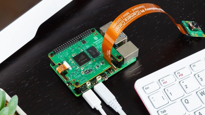

The Hailo-10H accelerator connects to the Raspberry Pi 5 via a PCIe Gen 2 x1 interface exposed through the board’s HAT+ connector. The direct PCIe attachment avoids the bandwidth limitations of USB-based accelerators and enables lower-latency data transfer between host memory and the neural processing unit. The board includes onboard power regulation to support the accelerator’s peak load while conforming to the Raspberry Pi 5 power envelope.
The Raspberry Pi AI HAT +2 includes 8 GB of dedicated on-board RAM, so it can handle much larger models than previously possible.
Improving on earlier models, the Hailo-10H supports larger on-chip memory resources and more flexible dataflow scheduling. This allows portions of larger models to remain resident on the accelerator during inference. The HAT itself adds 8 GB of onboard memory, which Raspberry Pi claims enables LLMs and VLMs with up to six billion parameters.
Like previous models, the board is mechanically compatible with standard Raspberry Pi enclosures and thermal solutions. The AI HAT +2 comes with an additional heatsink to be installed on top of the HAT. Raspberry Pi recommends using an active cooler for sustained high-load operation.
From a software perspective, the AI HAT+ 2 is supported by Raspberry Pi OS and integrates with the Hailo software stack, including model compilation tools and runtime libraries.
