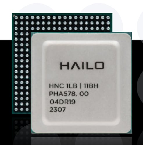

The Hailo-8L AI accelerator, included in the Raspberry Pi AI kit, features up to 13 tera-operations per second (TOPS), enabling real-time, low-latency, and high-efficiency AI inferencing on edge devices.
Hailo-8L
The Hailo-8L is an entry-level AI accelerator. Image used courtesy of Hailo
It can concurrently process AI tasks with multiple models and offers high power efficiency, with a typical power consumption of 1.5 W. This makes it suitable for solutions requiring limited AI capacity and low power consumption. In addition, Hailo claims its accelerator is scalable for products in the prototype or mass production stage.
