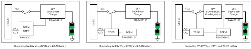

Architecture solutions enabled by the RAA489118
Architecture solutions enabled by the RAA489118. (View page 1 of the datasheet (linked) for enlarged image.)
The RAA489118 features Renesas’ Robust Ripple Regulator ("R3") technology. Renesas says R3 delivers acoustic noise-free operation, fast dynamic response, and better battery life efficiency. This is done by combining fixed-frequency PWM and hysteretic PWM. According to Renesas, by controlling the PWM frequency and duty cycle, the R3 modulator can respond to input and output load transients to synthesize an "ideal" output AC signal. This may provide light-load efficiency and extend battery life.
The RAA489118 operates from an input voltage of 3.9 V to 30 V, with an output of 2.4 V to 30.8 V. Renesas designed these output ranges to match mainstream solar power voltage levels and serve solar portable power station applications. Available in a 4 mm x 4 mm, 32-Ld TQFN package, the RAA489118 is also suitable for power tools, laptop batteries, and any USB-C interface portable device that requires batteries.

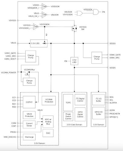

The RAA489400 (datasheet linked) is a USB-C port controller that supports USB-PD VBUS up to 48 V/5 A. The device is compatible with the USB-C port controller, cable and connector, and USB-PD specifications. The port controller includes integrated TCPC PHY and CC-logic. When combined with a single USB-C port manager, multiple RAA489400 devices can implement all USB-PD functions. This includes power negotiation and alternate modes to support multiple USB-C ports.
Block diagram of the RAA489400
Block diagram of the RAA489400. (View page 5 of the datasheet (linked) for enlarged image.)
The RAA489400 contains other built-in features for its use as a port controller, including an integrated VCONNN MUX. It also contains sink/source power path gate drivers with external NFET for its VBUS. It offers four-channel GPIOs for control and various signal outputs like OCP# and PROCHOT#.
The RAA489400 supports a max rating of 60 V on its VBUS (55 V recommended). It contains built-in OCP/OVP/UVP/RVP and short-circuit protection. Its CC1 and CC2 pins can provide EPR up to 240 W/48 V. The RAA489400 supports general-purpose applications up to 240 W, including mobile devices, electric bikes, power tools, and home appliances. The RAA489400 is available in a 3 mm × 5 mm, 32-pin FCQFN package.
