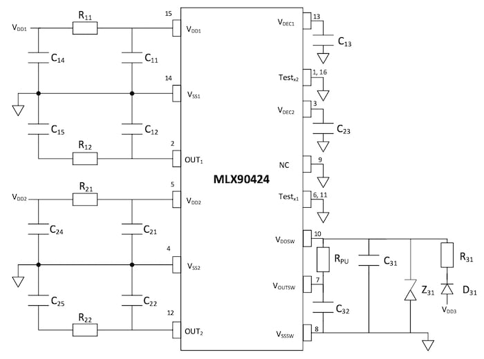

Melexis recently introduced the MLX90424 dual-linear position sensor that integrates position sensing and a magnetic switch within a single module. This integration significantly reduces the number of separate components in traditional brake pedal systems. By consolidating these functions, the MLX904 (Link downloads datasheet PDF) minimizes assembly complexity, optimizes space, and reduces the bill of materials (BOM) component count. The MLX904 can also directly connect to a 12-V battery without a regulator, further simplifying system design and power management.
Recommended application diagram for the MLX904
Recommended application diagram for the MLX904 in a TSSOP-16 package. Image used courtesy of Melexis (Link downloads datasheet PDF)
The sensor's linear displacement measurement capability of up to 30 mm, combined with Melexis' proprietary Triaxis Hall technology, ensures resilience against magnetic interference. With its AEC-Q100 qualification, the MLX90424 is also highly reliable in safety-critical applications. It meets the stringent ISO 26262 standards with ASIL D level integration for position sensing and ASIL B for the switch functionality. This level of integration not only supports robust braking operations but also helps protect against magnetic stray fields up to 5 mT.
