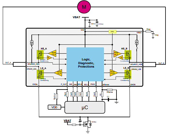

The typical application of the VNH9030AQ
The typical application of the VNH9030AQ highlights the power MOSFETs, gate drivers, and internal logic circuits that allow easy integration with few external components. Image used courtesy of STMicroelectronics
The VNH9030AQ also features a low on-resistance of 30 mΩ thanks to ST’s VIPower M0-9 process. This process not only improves the on-resistance of the power MOSFETs but allows for lower voltage CMOS integration that can provide the built-in diagnostics feature.
