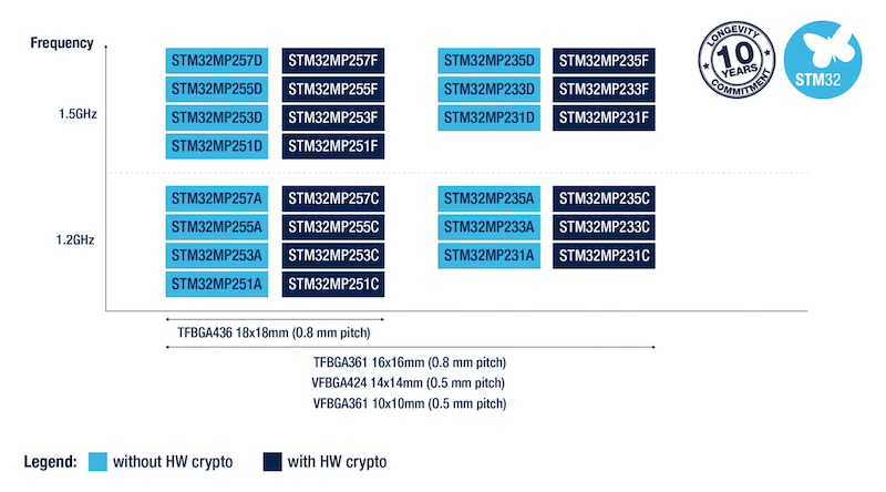

The STM32MP2 family portfolio
The STM32MP2 family portfolio.
The STM32MP253 and MP251 versions focus on industrial control and edge processing, with the MP253 offering three FD-CAN interfaces for distributed sensor and actuator networks. The MP251 features a single Ethernet port and reduced peripheral count to support cost-sensitive applications.
The new MP233 and MP231 variants offer baseline configurations for general-purpose processing, with dual and single Ethernet port options, respectively. Each device supports industrial-grade operation from -40°C to 125°C and optional hardware cryptographic features. The product line also targets PSA Level 3 and SESIP3 certification readiness with TrustZone support, secure boot, tamper detection, and cryptographic acceleration.

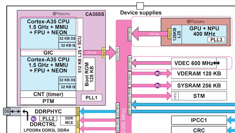

A portion of the STM32MP23xC/F's block diagram
A portion of the STM32MP23xC/F's block diagram. Visit page 11 of the datasheet to view the full block diagram.

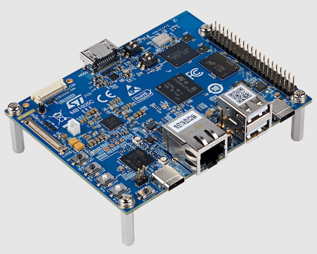

The STM32MP257 Discovery Kit
The STM32MP257 Discovery Kit.
Finally, developers can begin evaluation with the related STM32MP257 Discovery Kit, which ships with pre-integrated software and references for STM32MP23x-specific configurations.
