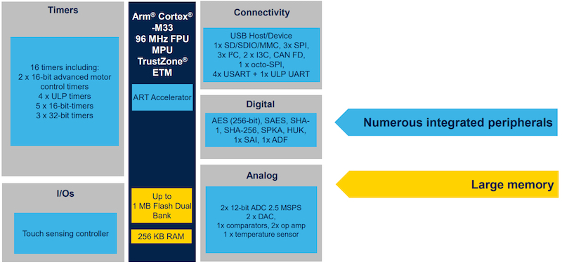

STMicroelectronics’ STM32U3 MCUs (datasheet linked) feature advanced power-saving technology for smart connected devices in remote settings, such as those powered by coin cells. To this end, the STM32U385xx series is built on a high-performance Arm Cortex-M33 32-bit RISC core that runs up to 96 MHz and includes a single-precision FPU supporting all Arm data-processing instructions, a full digital signal processing (DSP) instruction set, and a memory protection unit for enhanced security.
The STM32U3 series is also the first STM32 family to use near-threshold voltage technology, which dramatically extends battery life. The near-threshold technology operates transistors below the conventional power supply levels (1.20 V to 0.9 V). Core logic functions operate at voltages as low as 0.65 V. With this tech, the STM32U3 family devices achieve active consumption as low as 10 µA/MHz and "industry-leading efficiency" of 117 Coremark/mW with a static mode under 2 µA.
STM32U375/385 block diagram
STM32U375/385 block diagram.
