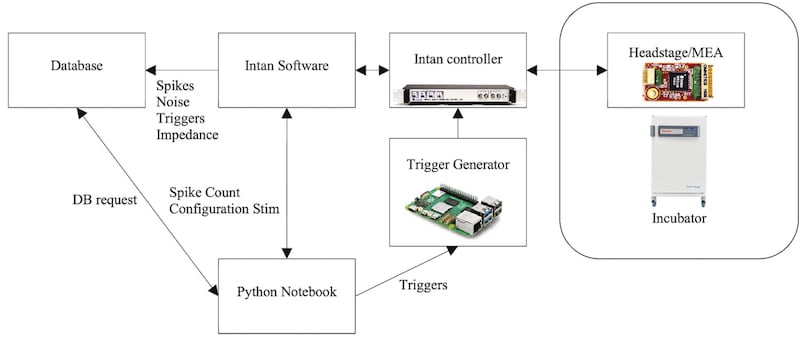

FinalSpark's remote biocomputing platform relies on hardware to preserve homeostasis, monitor environmental parameters, and perform electrophysiological experiments. Users can interact with the hardware using a graphical user interface (GUI) or via Python scripts.
Neuroplatform's general architecture
Neuroplatform's general architecture.
Taking a closer look at the hardware, FinalSpark’s Neuroplatform system uses four multi-electrode arrays (MEA) to capture real-time measurements of cellular activity. It also includes electrodes that stimulate and record electrical activity between each other. A closed-loop microfluidics system supplies Neuronal Medium to sustain the life of organoids on the MEA. The platform also leverages cameras for each MEA to capture still images or video recordings. Finally, Neuroplatform uses UV light-controlled caging systems to release molecules with a specific wavelength of light that breaks molecular cages when they contain a neuroactive molecule.
