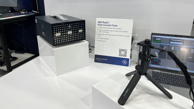

The new R&S RadEsT
The new Rohde & Schwarz R&S RadEsT Radar Essential Tester as shown at CES 2025.
The model R&S RadEsT automotive radar test system can simulate targets and test active radar key parameters. It covers many use cases in test and simulation to support complete automotive radar design, manufacturing, and validation.

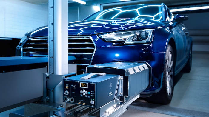

R&S RadEsT Radar Essential Tester. Image used courtesy of Rohde & Schwarz
R&S designed the test equipment to provide dynamic target simulation. It has 12 receive and 12 transmit patch antennas with different polarizations. The suite of antennas allows the unit to simulate different types of targets in different locations without needing to move the equipment or the vehicle. It can also choose appropriate antenna pairs based on the signal polarization.
The equipment performs the signal level verification test for the radar-effective radiated power (EIRP). EIRP and occupied bandwidth tests verify the general operation of the radar system and individual sensor quality.
