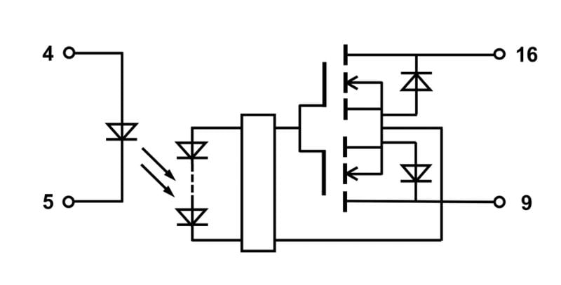

The TLX9165T’s internal circuit.
The TLX9165T’s internal circuit. Image used courtesy of Toshiba
Electrically, the TLX9165T is a 1-Form-A (normally open) relay with a trigger LED current threshold of just 3 mA. Switching characteristics include a maximum turn-on and turn-off time of 1 ms each. According to Toshiba, these specifications make the device an option for responsive BMS operations like ground fault detection, voltage monitoring, and relay malfunction detection.

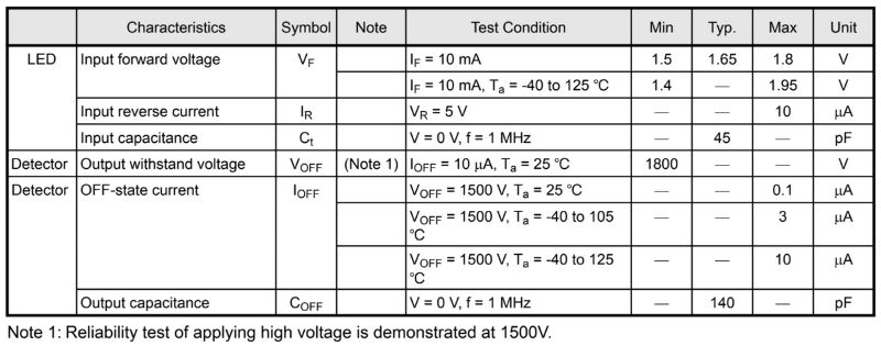

The TLX9165T’s electrical characteristics
The TLX9165T’s electrical characteristics. Image used courtesy of Toshiba
Achieving this withstand level involves careful component design, particularly around the MOSFET structure and packaging. A significant factor is using a high-voltage MOSFET with minimal leakage current and robust avalanche characteristics. Packaging must also incorporate sufficient creepage and clearance distances, which prevent arc-over across insulation paths. Standards such as IEC 60standards 664-1 specify minimum spacing and material group classifications to support different pollution levels and voltage categories.
In systems like EV BMS or battery storage system controllers, transient conditions and environmental stressors are common. A combination of high breakdown voltage and strong isolation characteristics is necessary. Without this, devices risk premature failure and compromised insulation.
