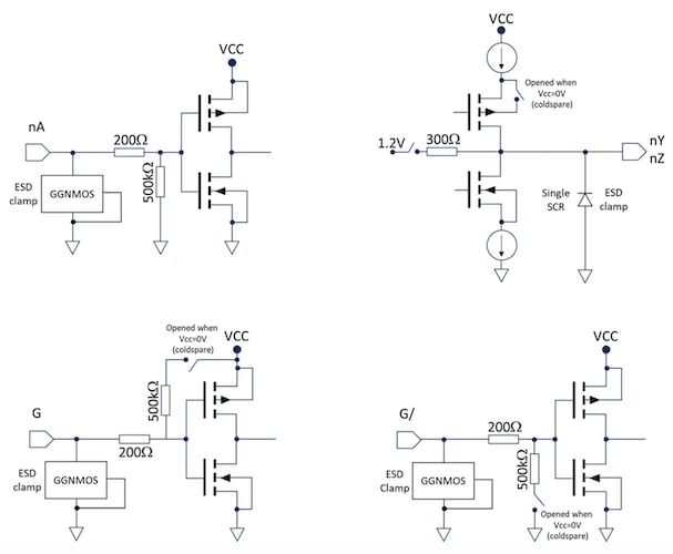

 I/Os equivalent circuit diagram
 I/Os equivalent circuit diagram.
ST has also paid attention to layout and system-level behavior, with a flow-through pinout that is intended to simplify routing and minimize skew and crosstalk on dense boards. Each channel includes enable control and fail-safe behavior. The outputs support cold-spare operation, allowing unpowered devices to remain connected to a shared LVDS bus.

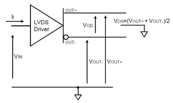

Voltage and current definition
Voltage and current definition.
By combining higher-than-legacy LVDS data rates with a wide, low-voltage-friendly supply range, the RHFLVDS41 addresses both pressures without introducing a new physical layer. Designers can maintain established LVDS signaling practices while integrating more tightly with modern digital logic and avoiding extra power dissipation from voltage translation stages.
