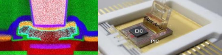

Inside a PIC100
Inside a PIC100.
The PIC100 also notably uses an edge coupler for fiber attachment. Traditional grating couplers, while easier to align during testing, introduce higher optical losses due to mode mismatch and scattering effects.
“Thanks to an innovative material stack up, PIC100 will also enable the attachment of the fiber to the edge of the photonic IC, thus reducing system losses—a constant challenge for any transceiver developer,” Fraisse said.
By adopting an edge coupler design, the PIC100 achieves lower coupling losses of less than 1.5 dB, resulting in improved link efficiency and longer reach compared to traditional optical transceivers.
