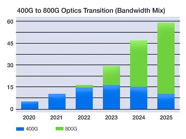

As demand increases for higher data rates, data centers will have to leverage photonics solutions
As demand increases for higher data rates, data centers may benefit from leveraging photonics solutions. Image used courtesy of Rosenberger
This is not to say that PICs are currently the optimal solution for everyone. Deploying a photonics solution could create many headaches for little improvement if the application doesn’t demand sustained high data rates.
